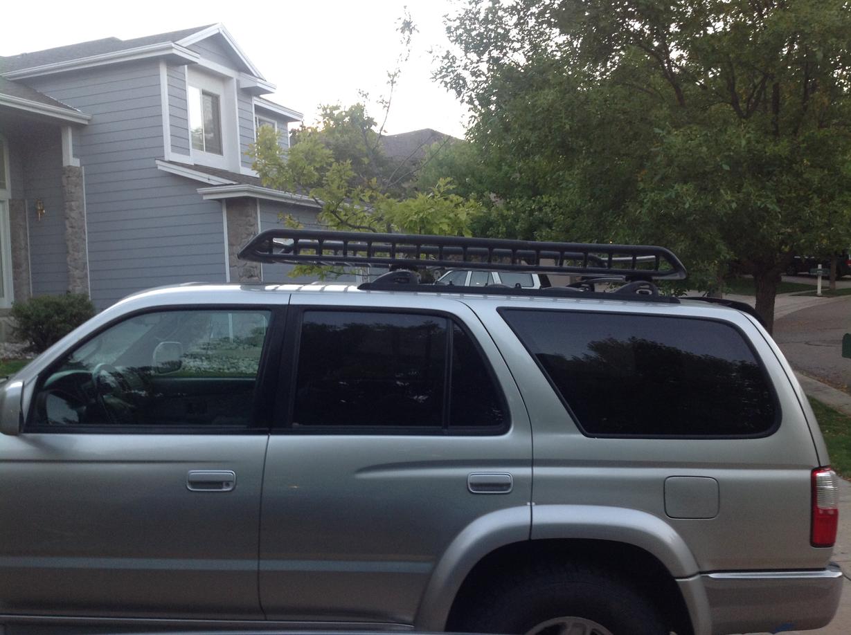

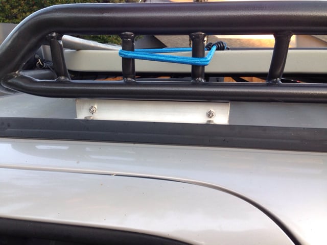

Used angled aluminum and the u bolts that came with the rack. Pretty easy actually.

I really like the way you mounted your Rola. Quick question, what are you using between the rack and your mount? I noticed you have some black pieces cut to fit your mounts. Is that rubber? Where did you get it from?

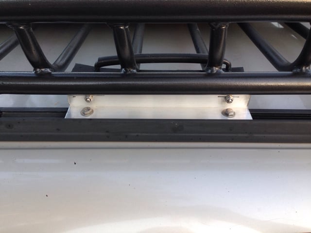

I found a super easy way by using the provided hardware. I wanted mine close to the truck so I notched the frame too.
Sorry the photos were kinda a pain to take:
Hey Jaketino.
Yeah it's just little strips of rubber I got from the local hardware store and cut to fit.
Uhh, my parkrose hardware store had a "random cut" bin with lots of pieces of rubber. I think it cost me like $0.30 for the whole small piece.
I copied Jaketino and got some 1" aluminum angle iron, stainless steel U-Bolts and runner washers.

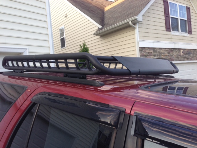

I really like the lower profile look and I plan on doing this mod. I picked up a used rack with the extension. When mounted on my 2001 4Runner, the rack now overlaps the sunroof. Do you guys think I should cut the extension back to eliminate the overlap, or leave the length as is? To make it fit without any overlap, I would have to cut out two bars segments...

It's mainly a matter of personal preference. IMO, I would leave it long, unless you love having an open sunroof without anything blocking the sun. If you want it shorter, just get rid of the extension. I doubt it's worth doing any cutting to make it look "perfect".
I still haven't made any custom mounts for mine, but still like the long rack. The higher profile isn't the best, but I just haven't got around to making some type of low-profile mounts.
