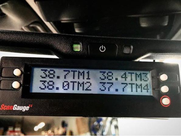

Got mine back and on a 2011 Limited TM1-4 gauges work. Very happy for this and is now my default view so thank you!

[MENTION=178113]ScanGauge[/MENTION] (or anyone on this forum) is there a function on the Scangauge II to have "presets" to quickly rotate through saved groups of 4 guages?
Now I have my tires set to the order of tire rotation (left top gauge is driver front, left bottom gauge is driver rear, etc) it would be nice to save all 4 settings saved as a preset screen. I would love to have the ability to have other user defined presets for groups of 4 gauges for things like gas mileage, performance, temps, etc.
As-is now, I have to cycle through all buttons each time I want to see the gauges I want to see at once. It wasn't such a problem before, but now that I have the tire gauges and want them to display in a certain order, its a PITA to cycle through the buttons when I want to switch to other gauges and back again.
Is this something that you could program into the next firmware release?
I was thinking the same thing. Right now the lower right HOME button with red circle will take you out of the screen with the 4 gauges and back to HOME screen. Be nice if this button could change/scroll to a different/next page (or pages) of 4 gauges before returning to main menu.
I'll see what I can do. Perhaps on a long 'HOME' button press instead of going home it would switch to a page of 4 pre-defined gauges on the gauge screen. First step would be to figure out a way for the user to set the 4 gauges they'd want it to switch to.

Currently going from HOME to gauges you use the GAUGE labeled function button. It takes you to the 4 gauges where you can change the 4 gauges as desired using function buttons. The gauges are saved such that exiting to HOME and then coming back has same gauges shown.
New proposal......from HOME push GAUGE labeled button takes you to gauges as above. Long push of HOME takes you to “new page” of 4 gauges. User uses 4 function buttons to choose gauges for this page. Another long HOME Button push takes you back to original page of 4gauges. Long pushes of HOME alternates between the pages with 4 gauges each. The gauges for each page saved as current single page.
Obviously saying it in words is much easier than executing within existing hardware and coding allowances. Lol

[MENTION=178113]ScanGauge[/MENTION] how or when will be able to get rid of the extra 5 TP gauges that don't report anything? Not a big deal but I wouldn't mind having 5 less things to scroll through when selecting what I want to display.

The SR5, TRD Pro, TRD Offroad, and Trail Edition (non-Limited) 2010+ 4Runners have 4 TPMS Sensors.
The Limited (ones with 20" wheels) have 5 TMPS Sensors.
If you go to X-Gauge, you can zero out their IO designations. After that, they will go away. :thumb:

False.......2014 limited with 20” wheels here and no 5th TPMS. Here is my TIS Techstream showing this.
