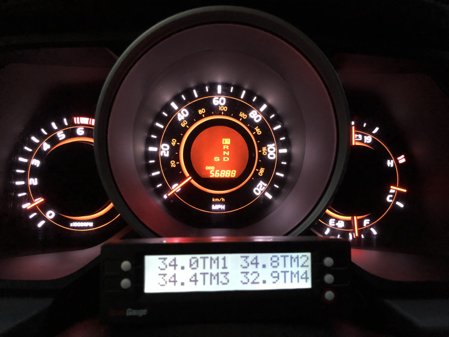

Another very happy customer with latest firmware and tire pressure \temperature x-gauges on Scangauge II. What a great experience working with OP-Thank you sir! What a great people, company and product!:clap2:
Sent my scangauge 2 in for software update and add the tire pressure codes. Amazing fast turn around time. The day the unit arrived, it was updated and completed then assigned a tracking number. Got it a couple days later.
Anyone able to provide the exact codes used? i notice everyone mentioning using TM codes which i cannot find on the scangauge website. I have tried all the TP ones they are listing and none show any pressures. I have a brand new scangauge II firmware 4.51 attempting on a 15 trail premium 4runner.
I added the xgauge stuff for the tpms, but nothing is showing up on the gauges. I used the codes from the ScanGauge website (both Method 1 and Method 2) but nothing is showing. Anybody have any ideas? I bought this recently and confirmed I have version 4.5x so it should be compatible.
There are several different sets of codes in pairs of four (one for each wheel). Try code one from each set till you get an accurate reading. Once you get one that works you know you have the proper code set and you can program them all in.
Also when you get to a code like TM1, let it sit there a minute or two. Mine would always start at 14.5 and take a minute to get the actual pressure.
In fact just set them to
TM1 TP1
1TT TT1
That would be 1 tire for all four possible locations. Let it run 5 minutes like that. If one pops in, then set all others to that name TM, TP, et. 2,3,4
