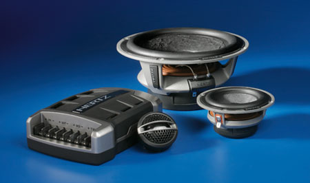

Looks like a good set up. I just sold a 3-way set of Hertz Mille Legend components that I had sitting around. Should make a for a nice set up.
