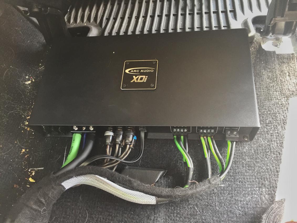

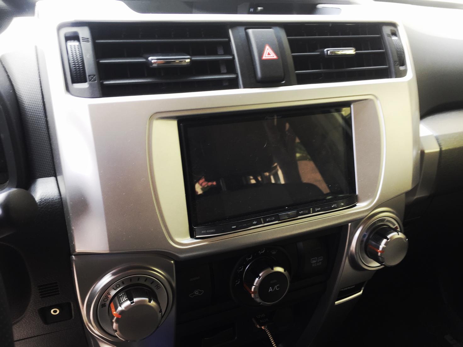

Nearly completed my audio install. I just need to find time to build and install the box for my sub. Anybody ever install a sub box behind the middle row with one of the third row seats up? Since all I have are car seats in the back, including one in the third row, I was considering building one to fit on the floor. There is definitely enough room to work with right there. (don't worry, I don't listen to loud music with my kids in the car).

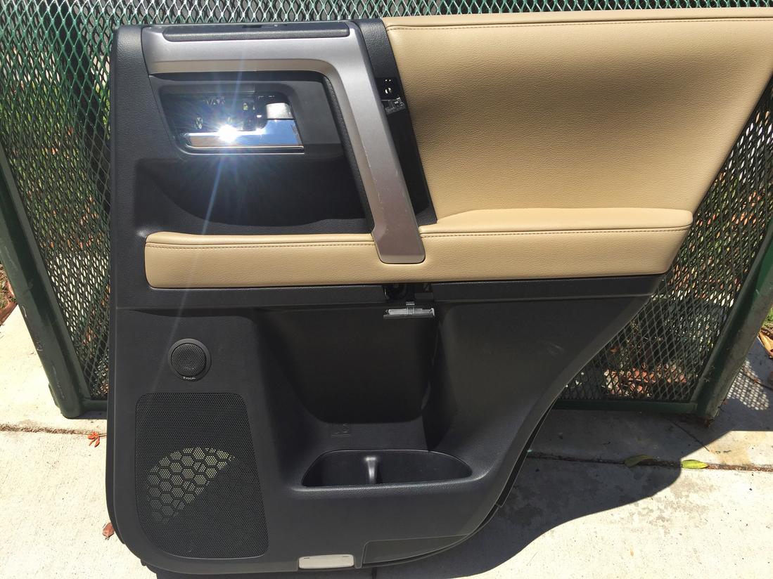

Looks great!!! That tweeter is for a component set in the rear doors instead of using coaxial speakers. I'm assuming her mounted the tweeters up front in the factory dash locations.

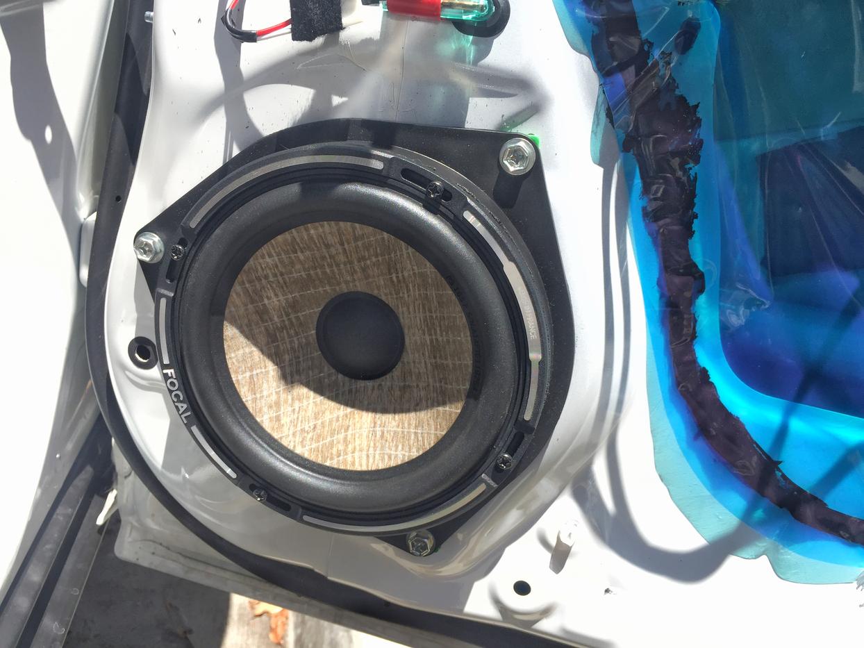

Where did you get the foam ring-things around the 6.5" speaker?

Thank you. The biggest challenge was running a complete rewire through the rear doors and then the front doors.
1: audiointensity.com and cartoys.com has the foam rings for sale. Cartoys.com also sells them on eBay.com so you can avoid paying taxes.

I did mount the tweeters in the stock location of the dash. The only reason I didn't mount coaxials in the rear is because of the deal I got on the speakers.

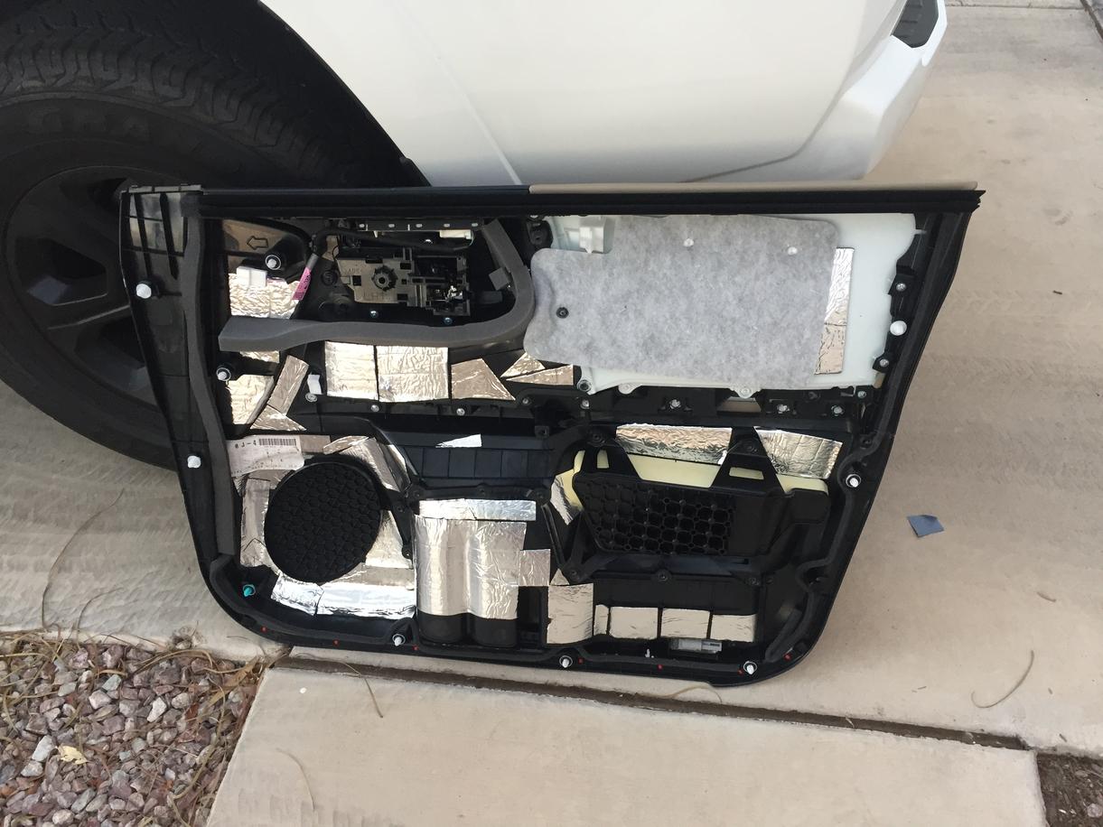

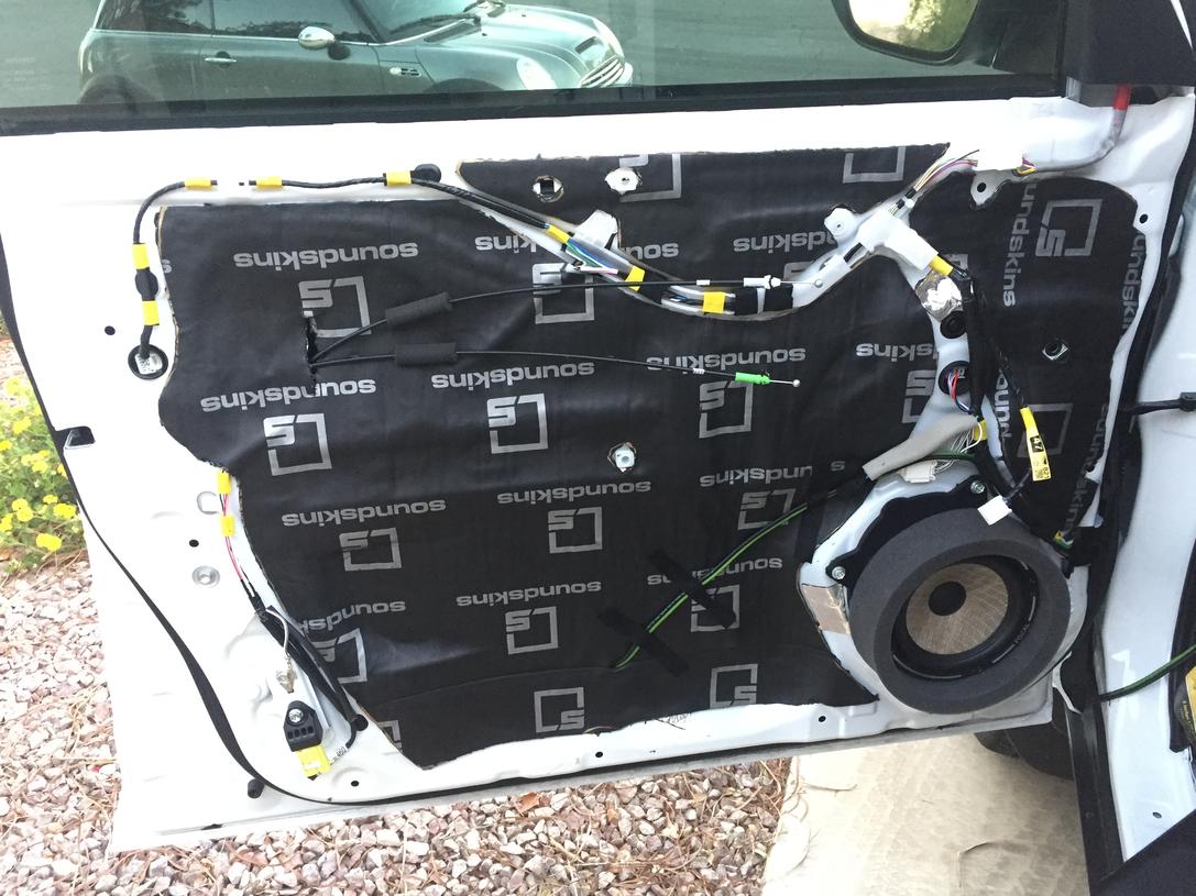

Update - got the JL-C2650 component set installed up front this weekend. No amp yet, but nice. Actually surprised how good the stock speakers sound considering the quality of the components. The JL tweeter weighed almost as much as the whole 6x9 door assembly.
Much cleaner sound, bass sounds in control and not "muddy" and the highs are much crisper. Fabbed a mounting bracket for the door out of 1/2" mdf, and 1/4" AC plywood for the tweeter. Added about 3.5 sf of deadening to each door too.
Only downside is with the tweets so far from the woofers in the doors, when listening to the stereo with the front doors open it sounds like total trash. This should be rare though, and why I'm using C2s in the rears and hatch so I can get good sound outside the truck in "party mode"
Also, if you forget to plug in one of the woofers, it really sounds bad.
