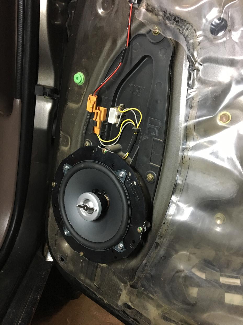

So I put new speakers in the front doors. I went with coax speakers to go cheap and easy. The factory tweeter is still hooked up and has sound coming out. My question is- should I unhook the factory tweeter? What effect will it have on the sound? Should I buy a new tweeter and install? I tried it both ways and couldn't tell any difference. Thanks, Dan.

x2 On going full component... By the looks of the pic your new coax speaker is wired exactly as the old woofer was and is very possibly passing through an OE crossover which is not only not designed to work very well with the new speaker but is also completely defeating the purpose of the tweeter in the coax...
I'd at least wire the new coax directly to HU or amp and then unplug OE tweeter.

Full components up front are the way to go. If wired properly, they’ll raise the sound stage. If you just connected your coax speakers to the factory wiring, all you did was upgrade your mids and mid-bass. That’s an upgrade for sure, but you’re still living with the same factory treble quality for the high pass frequencies being directed to the tweeter in the sail panel.
I suggest either running the tweeter wires to the coax if it is set up for dual inputs (increase sound quality by taking advantage of the new tweeters, although that will pull the soundstage below the dash), or put some aftermarket tweeters in the sail panel which would allow you to leave the wiring alone.

I have ordered a new receiver too now. I would prefer to not open up the doors again if possible. Already broke one tab off of each door. So I could add tweeters in the original spot and they would work then? If that will work that should be easy. This is my daughters high school car so keeping it pretty low budget and hopefully low effort. There are plenty of other things to do on this Runner.
also most forgot to add that you may be damaging your coaxial tweeter since you have it hooked up to the mid bass in line the wiring i would think is trying to push the same frequences a mid bass is designed to play seprately vs. together. That is why it is better to run a component set that drives the mid bass woofer and the Tweeter seprately. it would be a huge difference in sound.

unfortunatley the only thing you can do is replace the speaker with a component set. is the coaxial you have right now a 5.25"? if so stick it in the rear door and grab a correct set of 6.5" components for the front doors. they should be very inexpensive.

That is a great idea. Thank you. I ordered some JBL 600C for supposedly half price of $50. I guess I’m taking off the panels again [emoji853]
