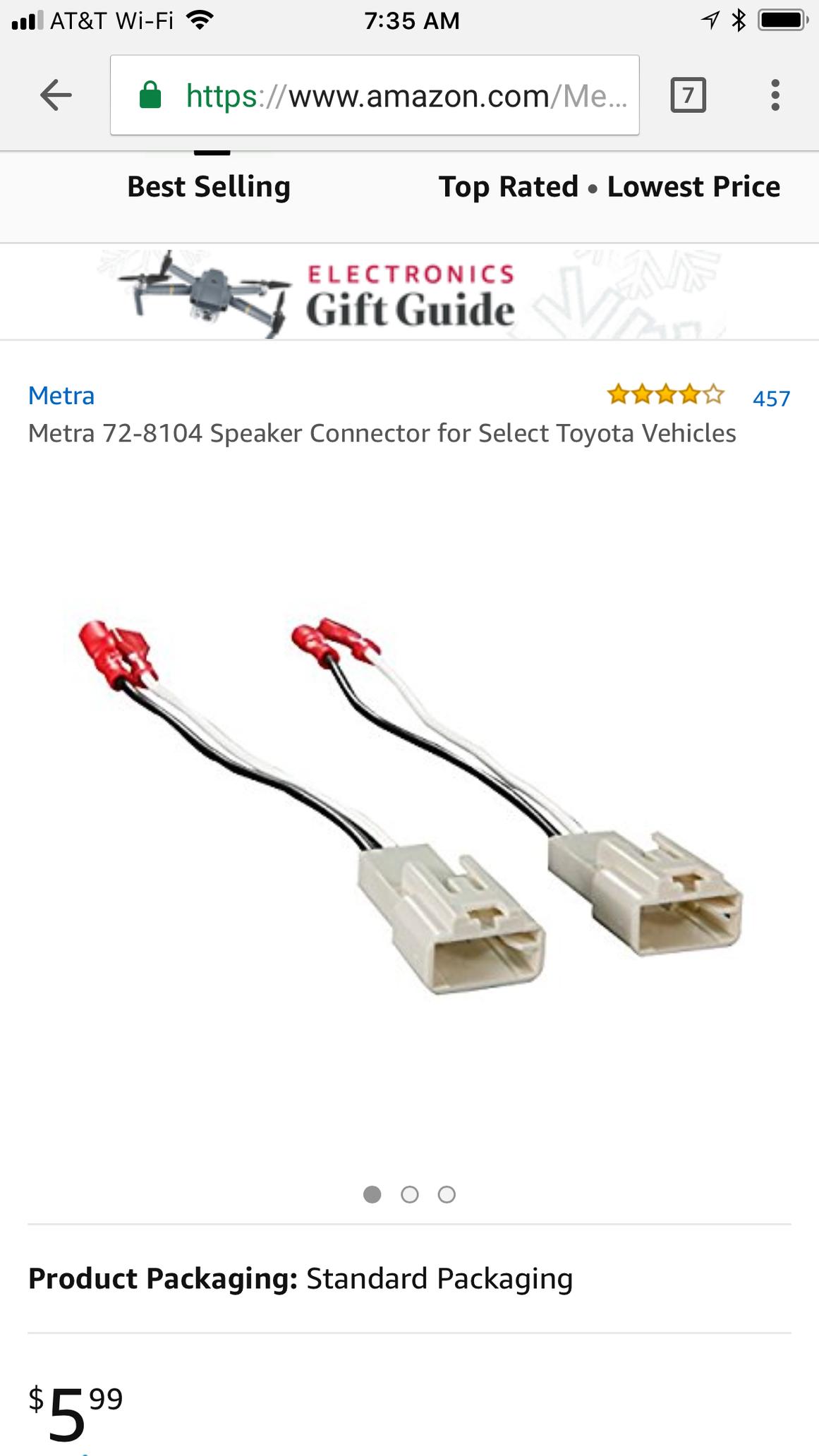

The current adapter? What/where is that? Is it between the woofer and tweeter?
You’ll see it when you open up the door...can’t miss it. It’s located between the woofer and the door. There’s a little clip on the door that holds the part that plugs into this harness in place. If you buy from crutchfield they will sometimes throw them in for free. If not they’re available on Amazon for like $6. Here’s a photo:
