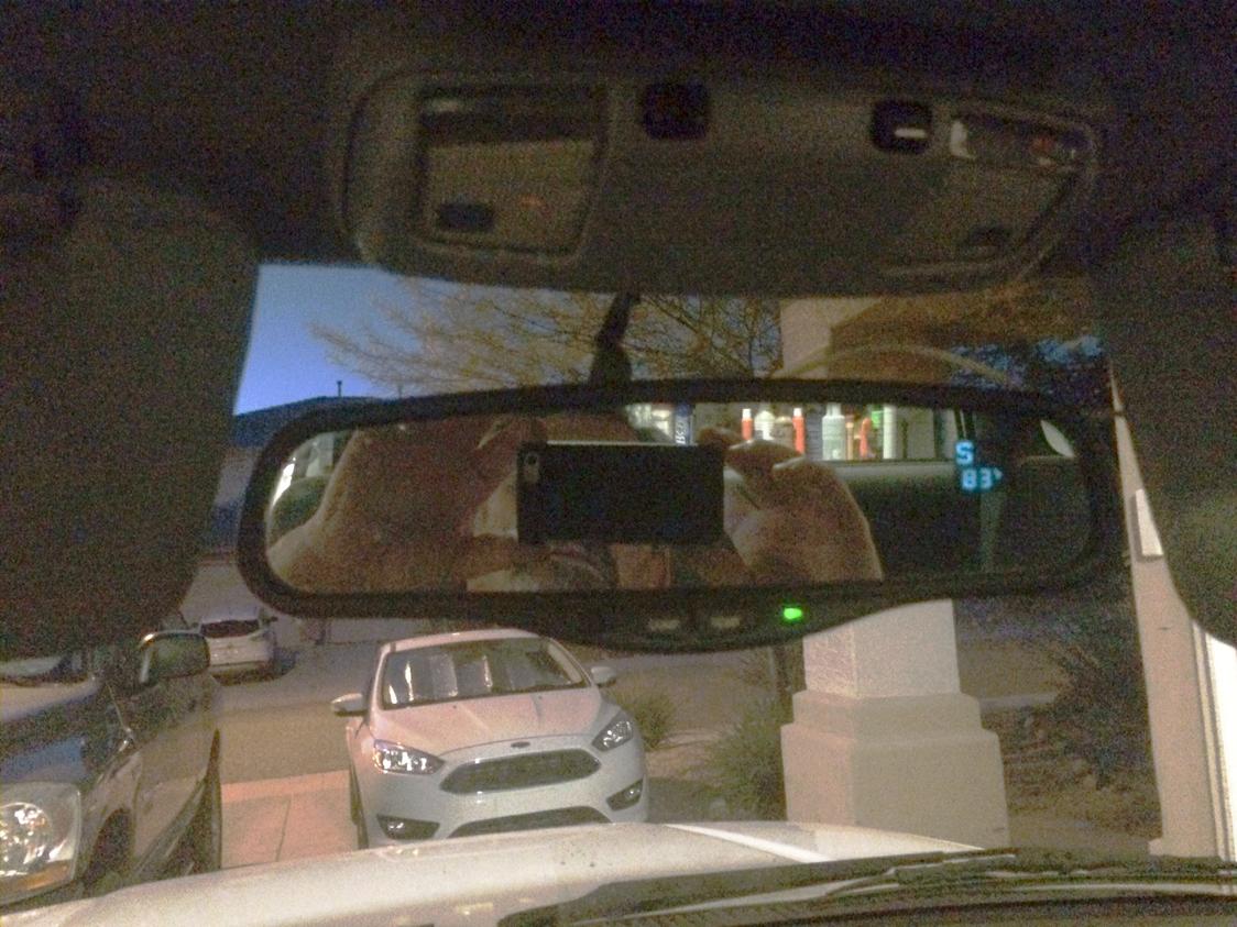

Don't mount that thing too low like mine is. It cuts off your ability to see quite a bit.
Will install as close as possible to the Field Monitor Unit like my current set up in the picture above.

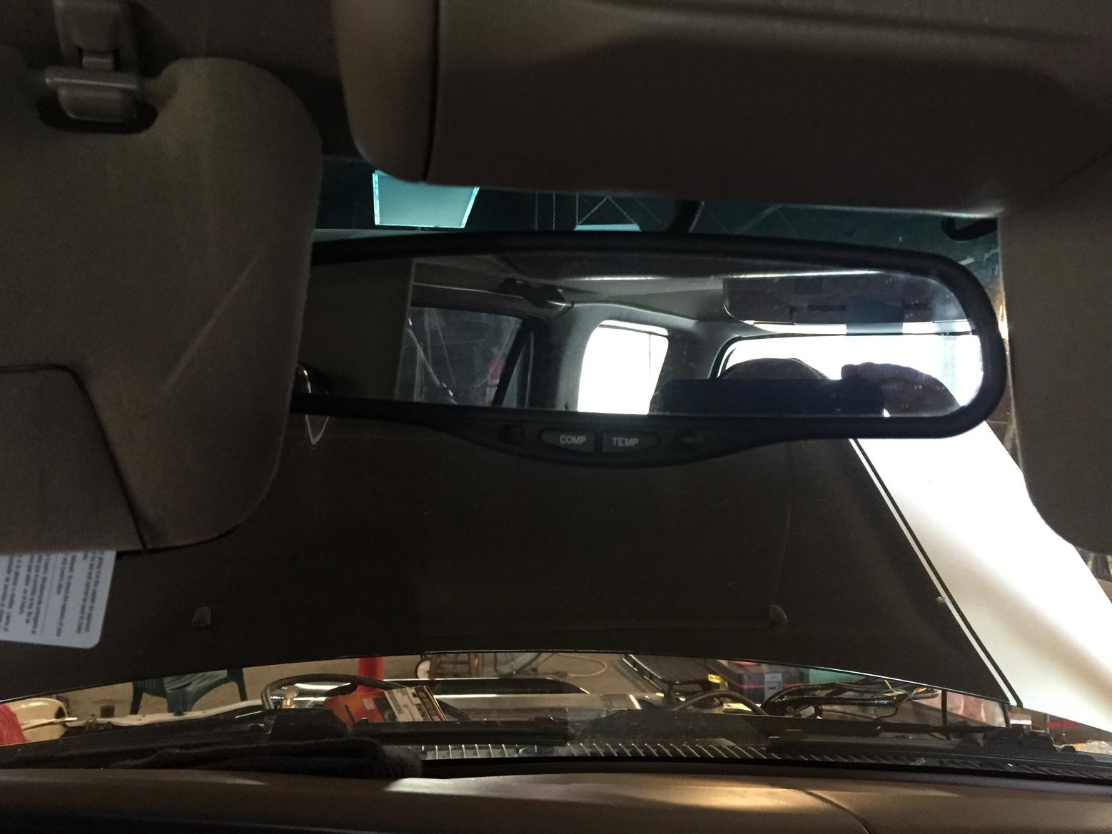

Hello my good Sir...I apologize for taking so long to get this posted! The passenger's Sunvisor misses the mirror by about 1/4"...then the driver's Sunvisor over-laps the mirror by 1 1/2". But, remember how I was attempting to explain how the mirror was adjusted at an angle. By doing this it allows me to drop both Sunvisor down and use them without touching the mirror. Once again...sorry for taking so long to get back with you.
I hope this helps...
- Russel

Finally got the mirror mod done and am very happy with the results. I snapped a picture with the sun visors down to show the clearance 1/2" on left 1/4" on right, and this is with it set for proper rear viewing
Thanks nissanh for the great writeup as i knew right where to go so as to not break any clips....
