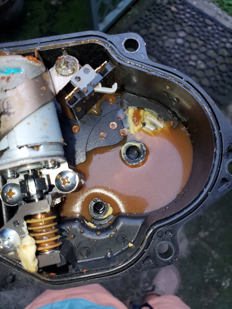

Opened up the old ADD actuator. Removed the 5 Philips screws and the cover required a hard rap to remove. Unfortunately the gears popped out. Been searching for a link to retime the gears without success. Any links or leads would be appreciated. The unit looks to be in good order except for being in 5 separate pieces. Haha. Could use a diagram or instructions.
Regarding the damaged electrical harness. Parts desk ordered the wrong unit. New part arriving Oct 15, hopefully.
The replacement ADD from Toyota was defective. A second unit ordered and installed. Wiring harness replacement installed.
