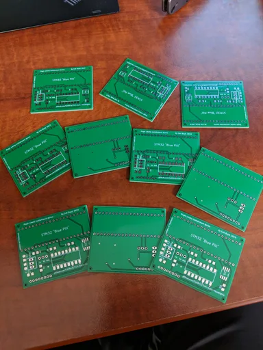

After much tinkering and tweaking, this will have two configurations (same module and firmware. Configured via jumper or config option over USB.). Both require the OEM light sensor (2 minutes worth of work on 4Rs that have the wiring harness)
  1. CAN bus only operation – In this configuration the device will work exclusively over the CAN network. No wires will have to be tapped, cut, or interrupted.
    Everything will work like stock with the below exceptions. This could be a small box plugged into the OBDII port or integrated under the dash. Only 4 wires are used, all present on the OBD2 port (12V, GND, CAN H, & CAN L).
    This is an idea what the enclosure could be for one that just plugs into the OBD2 port:
    Exceptions:
    • DRL running lamps (DRL is just dimmed bright lamps) will be on whenever the ignition is on. This includes when your headlights are on.
    • You instrument cluser and radio will not automatically dim like they do with the TRD Pro/Limited auto-lamps.
    • The crawl control (if equipped) backlight will not illuminate when headlights are on.
  2. CAN bus + switch light harness operation – In this configuration the device will work 100% like OEM auto-lights on the TRD Pro/Limited, no exceptions. The wire for the DRL switch position must be interrupted/cut. Both ends need fed to the device. The switch wires for headlights and tail/parking lights must be tapped (but not interrupted). This install will have to be integrated under the dash. 8 wires are used (12V, GND, CAN H, CAN L, DRL from switch, DRL to MPX/BCM, Headlights, Tail/parking lights).
Option #1 is ready now. I haven’t started on option #2 yet, but it’s just simple optoisolators and minor code changes to drive GPIO pins instead of firing messages over the CAN bus.
My question is, of the people interested, which way would most people want to go?
I've posted the code to git hub. To any adventurous enough, you can start testing and contribute to the code or design there.
GitHub - ColtB45/T4R-Auto-Headlights: Automatic Headlights for 5th Gen Toyota 4Runners
I've migrated to the STM32 as the primary platform, but included my original work on the Teensy. The STM32 Blue Pill is much cheaper ($3 locally, $2 from China), and while not quite as capable as the Teensy, it's more than capable for this project.
It's been a productive night. I've got the first production ish board completed.
While this one does work, there are a few things that are off. I didn't have 3 of the SMT resistor values I needed, so I substituted thru-hole. I also had to use headers to mount the STM32, making it sit much higher than a final board would.
Overall I'm pretty pleased.
I'll try to slap it in an enclosure and install it in the 4Runner tomorrow. I'll take pictures of the install and videos of it working.
