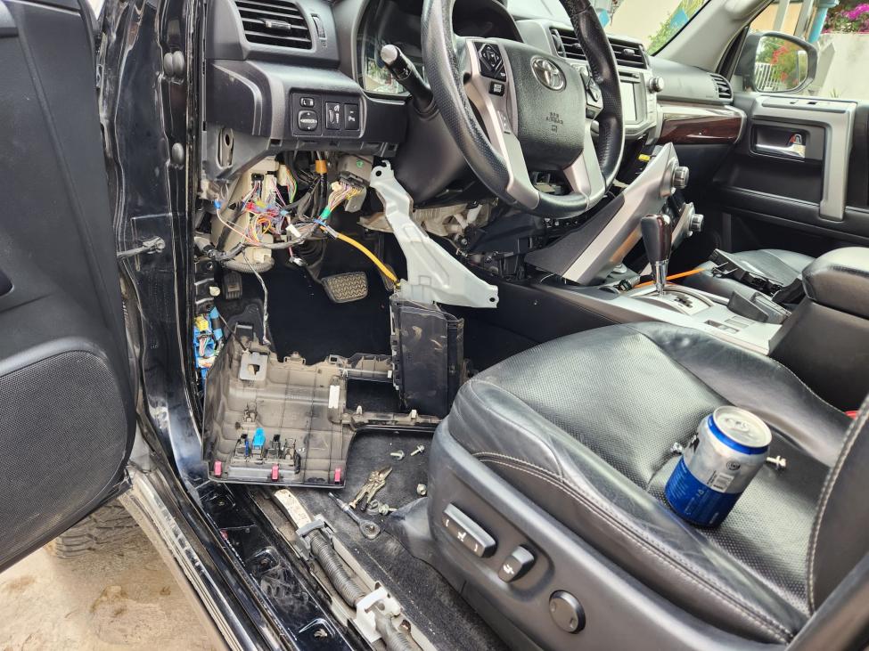

This thread inspired me to get my updated running board ECU replacement installed over the weekend. Up until now I had the 30amp fuse under the hood pulled and the running board were fully extended over the winter.
Getting to the module requires removing drivers door sill, kick panel, underdash trim and unbolting the drivers side underdash airbag module (not the one on the wheel) and letting it hang while doing the work. The clip to unplug it looks tricky and I didn't want to damage it.
Next was disconnecting 6 plugs on the body ECU that point directly at you once removing the underdash. This allowed me to unbolt and move the body ECU out of the way. The bottom plugs facing up I just left in place. Two of the plugs on the left had levers to unplug them, starting from the top. When reinserting them make sure the lever is fully seated down, the lever lock pulls the plug in.
The ARB ECU was then bolted to the side wall, above drivers kick with two 10mm bolts, on on top and the other on the bottom.
Once installed, the initialization procedure wants you to flip the switch on/off times and leave on with the 6th all within 3 seconds. You have to flip it pretty fast in that time frame, it took me a few times to get it. If you do not initialize the module the running boards wont do a thing and make it look like something is wrong with it.

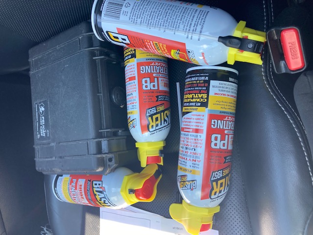

I used BLaster --- you can get it at NAPA. I used 2 cans per side---- Boston winters destroy metal.
Soaked the hinges as shown in video - let it sit and then worked it in as the video shows. Did it several times to get them working 100%
Sloppy work- but the dealer wanted $2000 to replace them, and I do not use them much - so there was no way I was going that route.

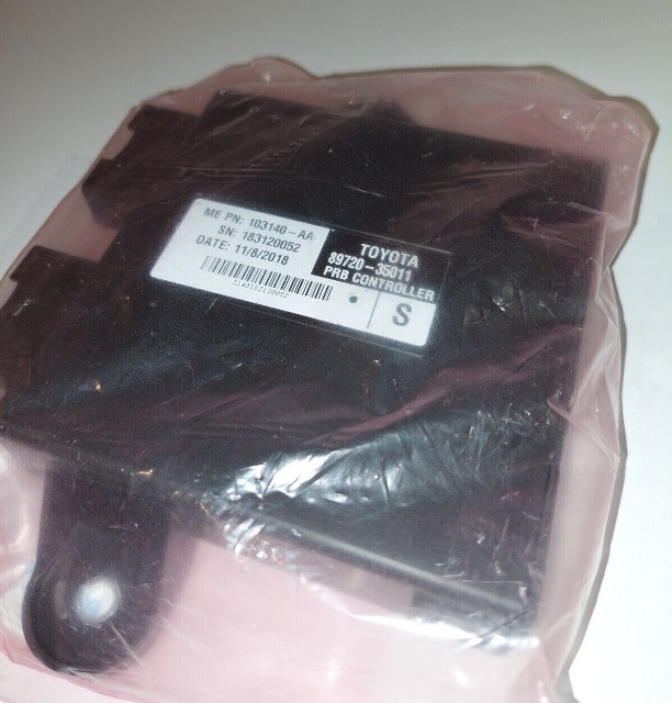

Thank you for posting the steps! I drive a 2016 Toyota 4runner Limited with about 69k miles. It has power running boards and a couple of months ago the one on the passenger side stopped working. It would rarely deployed so I thought it was a wiring issue but after inspecting I realized there was nothing wrong there. I bought an ECU with a newer Software version, mine was 89720-35010 and the one I bought is 89720-35011. I bought it for $55 plus tax and shipping for a total of $72. I guess I was lucky since I just noticed the seller increased the price to $85:
OEM Power Running Board Side Step Control Module Toyota 4 Runner | eBay
You described the steps almost perfectly and I felt I had to contribute my findings. First of all, removing the underdash trim is tricky, you have to remove the A/C controller panel first (where the A/C knobs are). The other important thing to note is that the initialization process you described works
if you have at least a door opened on each side. At first I had both doors on the passenger side closed and I was freaking out that the initialization process wasn't working, but then I opened one of the doors on the passenger side and the initialization worked on the first try.

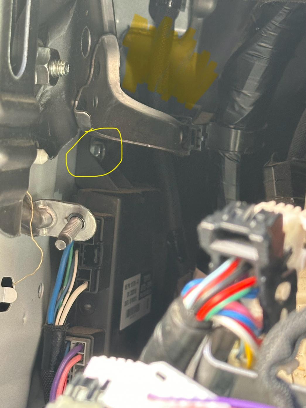

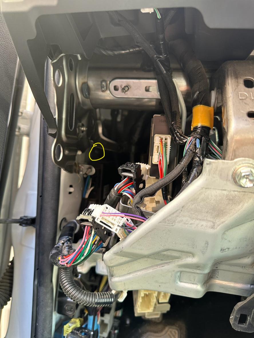

Wanted to chime in. Followed the steps above, bought the exact same part, and we have ARB again!!! I could hear the motors still functioning, and move for just a moment, but neither of the boards have came out for years now. 2014 Limited. :biggrin1: thank you!!!!
Pics attached of the location of that ridiculous nut! You can fit a wrench onto it from above (highlighted) once you take the ECU block out of the way.
