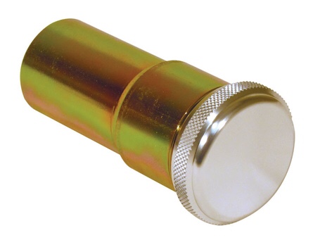

Why not buy a filler neck with a cap and have a separate filler neck for the aux tank? Like this.
http://www.tanksinc.com/index.cfm/p...t_id=510/category_id=166/mode=prod/prd510.htm
