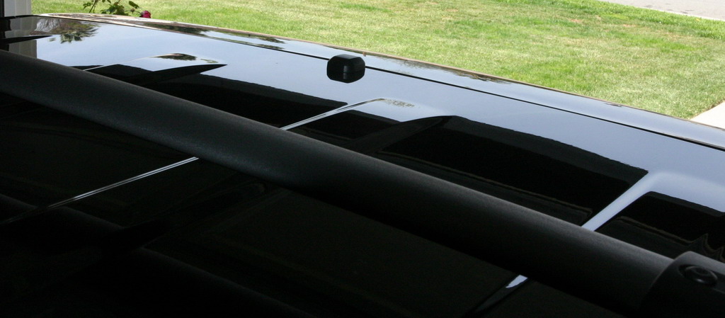

It is mounted on the roof towards the rear-middle. They ran the wire thru the headliner and then thru the hi-brake light wire loom. Very neat and professional, looks like factory installed. At first I fear water would run in there, but after a few car washes, no problems so far.
do you know where does toyota mount their antenna? i just curious.
