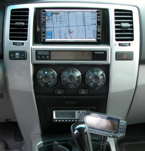

I took a photo of my new Eclipse. I really think this is a better choice than the Toyota navs from oem value for the non JBL trucks. The AVN gives MP3, Sirius. and an external video input extra. It still supports stearing wheel controls and a rear camera. The camera will be my next project.

If you are not adding Sirius the install is completly plug and play except for three wires. Since Fujitsu ten makes the stock radio and Eclipse, The connectors are the same. It mounts with the stock radio brackets with the Schotche Toyota Double Din adapters. Only the Speed, Backup, and Parking Brake wires have to be connected. The rest plugs right in. The GPS antenna is velcroed to the air conditioning duct in almost the same spot as the factory antenna. The old long thread has all the details including photos!

If you look behind the radio after it is removed you can see two air conditioning ducts with a gap between them. The factory antenna mounts on a bracket in the gap.
The antenna is so tiny there is more than enough room to velcro the metal ground plane square to the top of the duct in nearly the same location as the Toyota antenna. Then just stick the antenna to the plate with its magnet. I coiled the excess cable and taped it to the top of the other duct so it was out of the way.
If you use the vol top, bottom,top,bottom secret sequence to get into the diagnostics menu it always sees six sattelites so I presume the unit has a six channel GPS receiver. Correction. It appears to have a modern 12 channel receiver. At cold startup it will show 12 channels. The most sats that I have received is eight with a nineth flickering. Pretty good for not having a roof mounted antenna!
