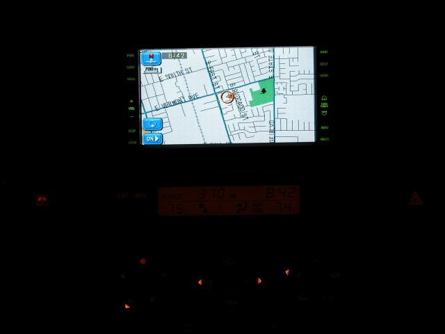

This is the night photo you wanted. I had the white on black night mode disabled so the screen is very over exposed.

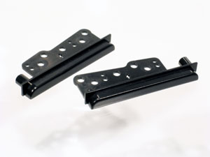

Scosche TA1465B
Hi GlennD, great write-up BTW where i can buy or order the Scosche TA1465B dash kit.Thanks

Re: Scosche TA1465B
I purchased them locally. I went to the website and looked up local dealers. I went to one in Cerritos that sounded high end and they had them in stock. I am sorry that I forgot the name as they were very helpfull.
Crutchfield carries Scosche so I would guess that they could supply them.

thanks GlennD most of local(sacramento) shops didn't carry it but i found it here
http://www.cardomain.com/item/SCOTA1465B

scosche double din kit
you can purchase the scosche double din kit from cardomain.com for about $8.
