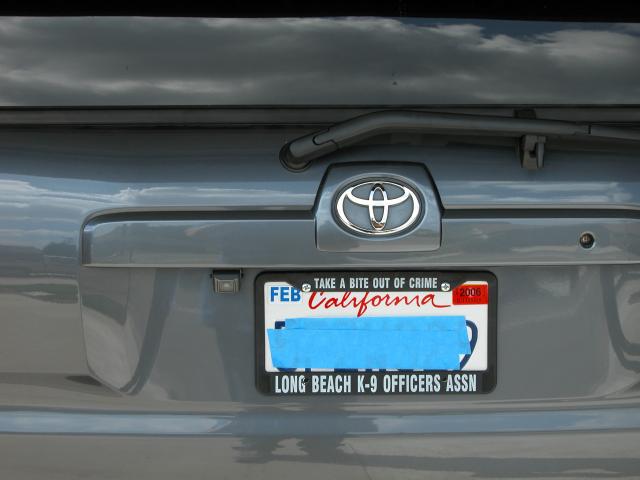

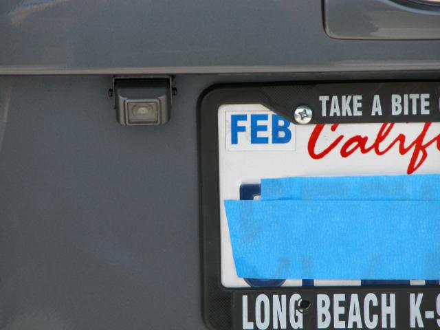

I installed the Eclipse camera today. I painted it with AutoZone Gunmetal Gray. I did not inset it since someday I will trade in the truck and I all ways put back the stock radio. The color is close but it is not as blue.

I have found a minor problem with the back up camera. It was raining today (rare in Southern Calif) and it looked like I was backing up in New Orleans! It really needs a tiny wiper.

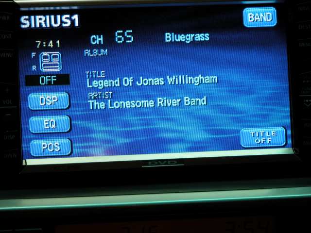

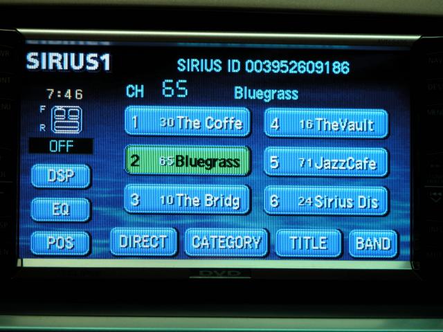

Since Sirius Satellite Radio has been discussed lately, Here is the Eclipse Sirius screens.

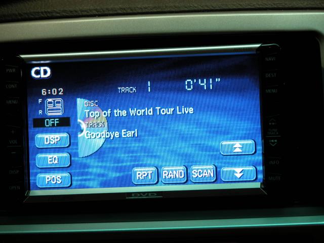

Here are more photos of the Eclipse screens. They would be better if I could find my tripod.
