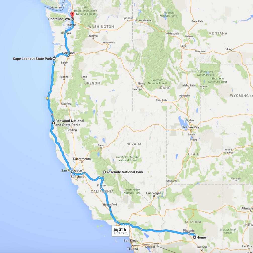

So we have a long road trip planned in October in which we will live out of our truck. Traveling from Az to Shoreline WA.
Plan on camping in Yosemite, Redwoods, Need to find an awesome campsite on the Oregon coast.
Along with the critical maintenance items we are beginning our search for gear.
Fridge - Danfoss type, Looking at Whynter and Dometic/Waeco.
Tent - Ours is super old would like a RTT. Pretty set on a CVT Mt. Shasta
TBD
Anyone who does long trips I would appreciate suggestions on gear etc...we wont be hitting any trails other than some service roads maybe.
Route Planned. On to inventory.
TBD

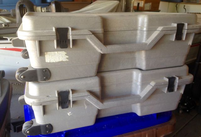

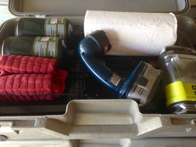

Also after putzing in my garage I realized I had some pretty amazing storage trunks for all our camp essentials (matter of fact I have a wall of them but they are stuffed full of unopened Barbies dating back to the 80's, I had to do some rearranging to get these, shhh don't tell the wife). They are some sort of case from a long defunct educational program from Cali that my wife inherited. They are super tough and weather sealed. I personally like the wheels and the spring loaded handles for easy maneuverability. One is filled with cookware and supplies while the other is the stove and pertinent items.
Heading out tomorrow for some camping and Overland Expo West. Sealed the tent like a mad man cause i'm not going to go through what we did last Overland Expo West. Also using a larger tent just in case we do get stuck in the rain we dont have to be stuck in a laying position for 17hrs straight.

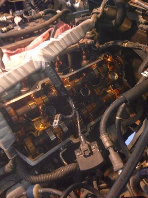

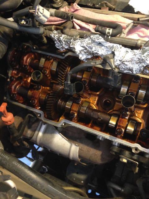

Started the VC job. Have appropriate reference material ready to go!
Just a reference for me. What the Valves looked like.
