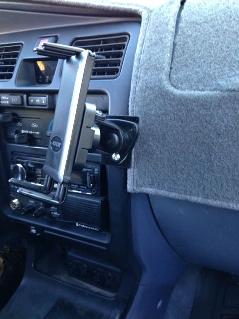

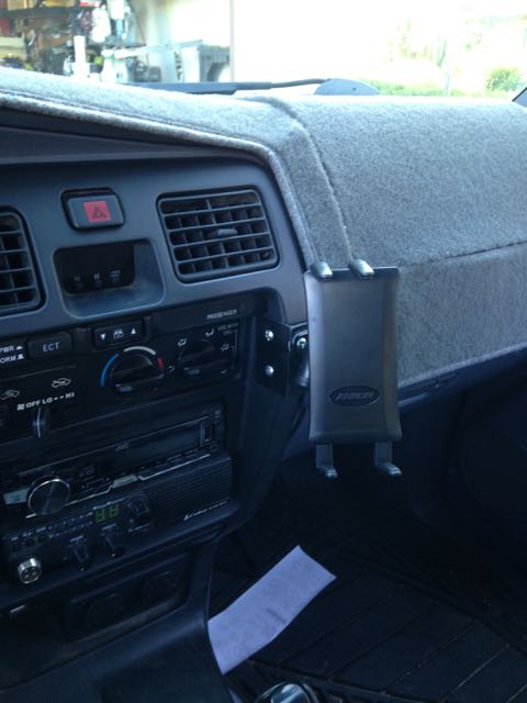

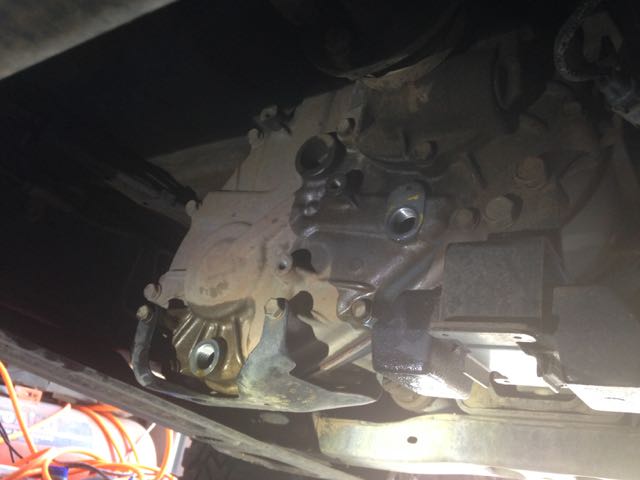

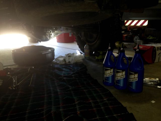

Changed out all fluids and crush washers on front and rear diffs and the TC. Was pretty dark, but not much on the magnets. Also installed a phone holder I got for $9.00
Ordered stuff to extend diff breather.
