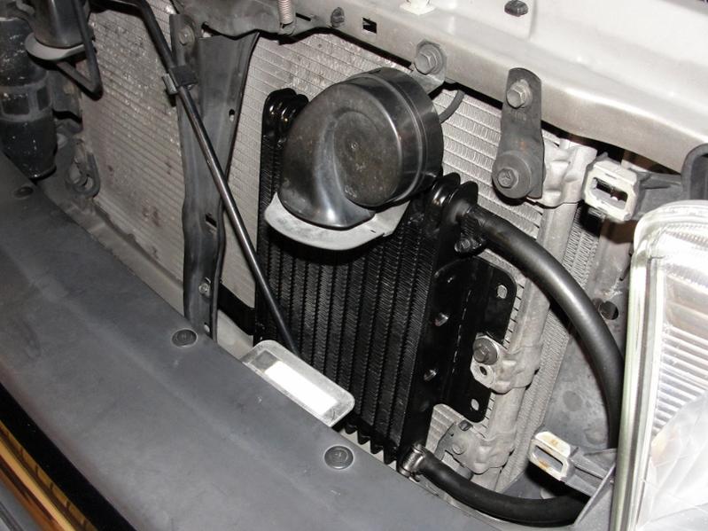

been installed a couple months now but i put mine here. 01 explorer cooler works great and the trans thanks me! i also have a tundra cooler for sale if someone needs one. :clap2:
Maybe it's an allusion, or maybe I'm just stupid. but what the heck is your transmission cooler connected to in this photo? Unless I'm looking at this wrong your tubing appears to go in a loop...

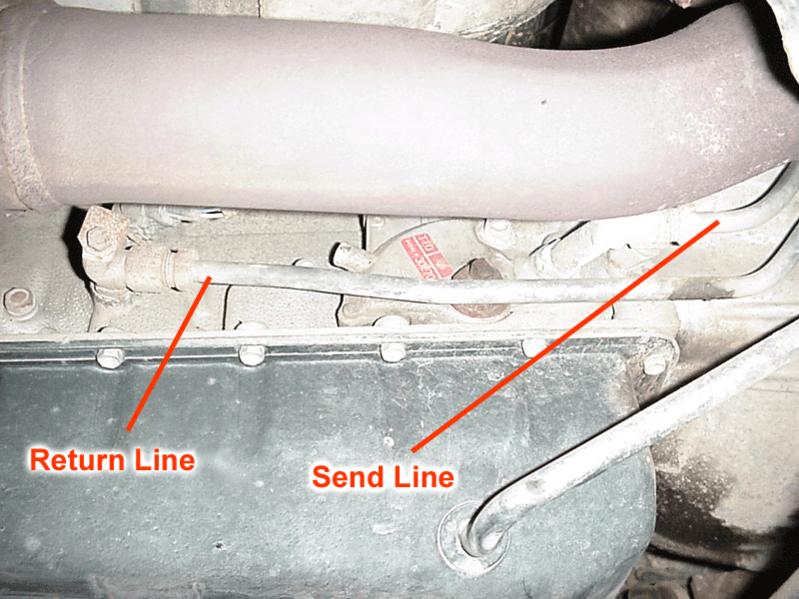

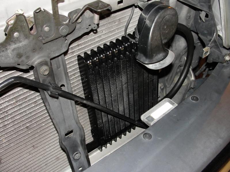

I mounted the cooler on its side on the passenger side of the ac compressor, with the send line on the bottom and the return line on the top. The whole job, start to finish, took a little over an hour and a half- the toughest parts were getting the routing of the hoses just right, and removing the old hoses from the transmission send an return lines- they were really on there tight and there isn't much space for your hands and wrench to get at them.
Overall the job went well. after everything was finished, I started it up, replaced the lost fluid, ran it through the automatic gear settings, checked for leaks, took a 5 mile drive, and checked for leaks again.
Here's a pic of my setup:

In from Trans should be on bottom top should be return to transmission. You have it backwards
If you re-read my post, you'll see it says that I mounted the send line (transmission to radiator) on the bottom, and the return line (radiator returning fluids back to the transmission) on the top. I've read that you can hook it up either way, but the B&M instructions recommended having the send line on the bottom and return line on top. Either way I'm just glad to have the possibility of the milkshake eliminated. :reddance:
i wasn't finished with the install. that was just a piece of hose sealing the inlets. both hoses go through a hole in the support.

Sounds good. After studying the photos I realized that by mounting sideways, it's just longer, not wider. So it would just cover a bit more of the radiator than the normally 7" kind but not really worried about that.

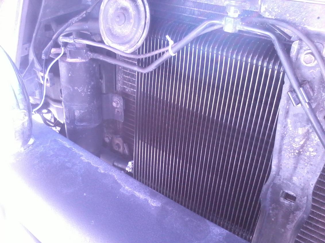

After looking at my radiator for a while today, trying to get a good idea how to tackle this job, i realized my radiator drain valve doesn't have the hole on the bottom like all of the pictures I've seen. I'm starting to think this isnt a stock radiator. I'll take a picture and you giys can tell me what you think.
So here's a picture of my 4runner, and a few pictures of the bottom of the radiator. Sorry for all the dirty spots, maybe i found a couple mud holes today. Is there enough evidence here to say that this radiator has been replaced?

Bartledoo, I would not fret much about the lack of the hole on the bottom of the petcock plastic screw bolt. All you need to know is when you do remove the plastic bolt to drain the radiator is to expect the coolant to come shooting out to the aft of your radiator and not straight down like on all other 4runners of this generation. Looks good to me.
