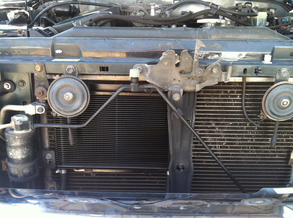

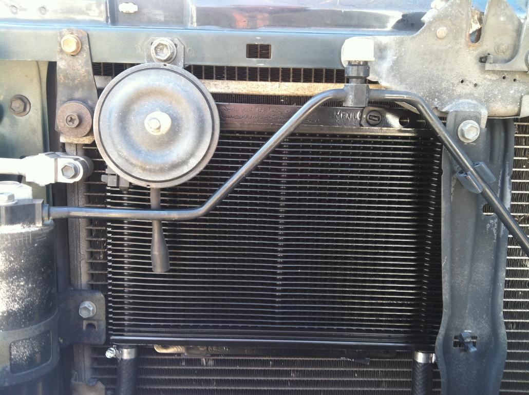

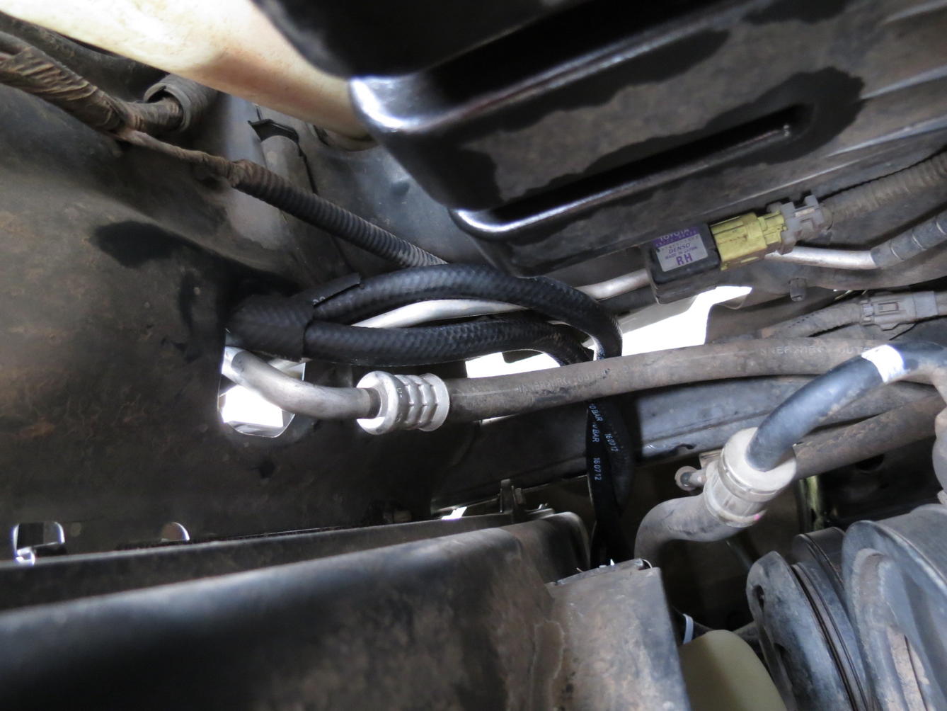

I am approaching 100k miles and passed twelve years last June; figured it was time to de-pinkmilkshakeify by replacing the radiator. I've been doing a little towing lately, so I decided to throw a B&M in there (in series) at the same time, along with a filter. Here's a couple pics:

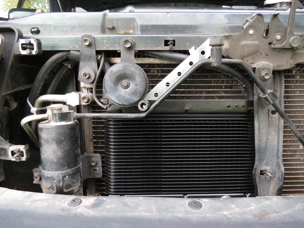

Here is how i mounted my B&M 70264 to help others out with this mod!

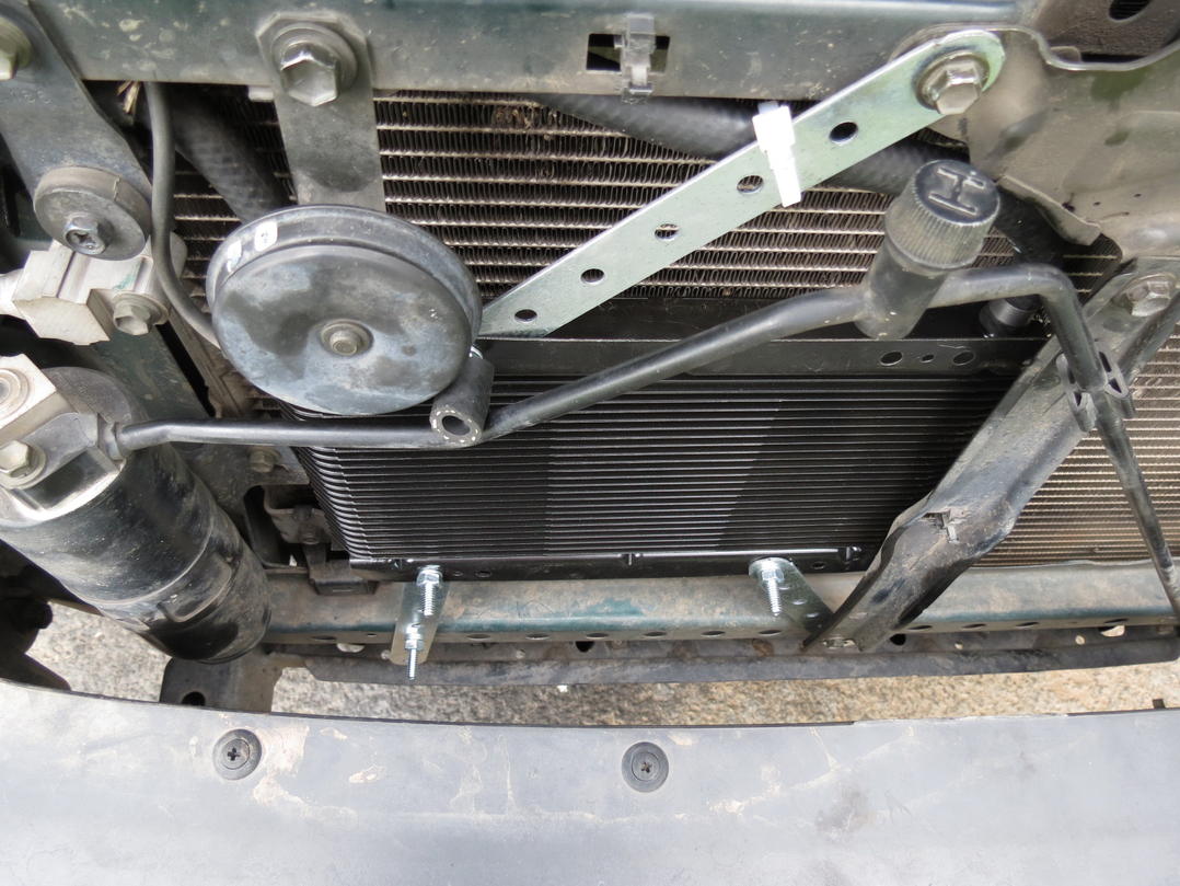

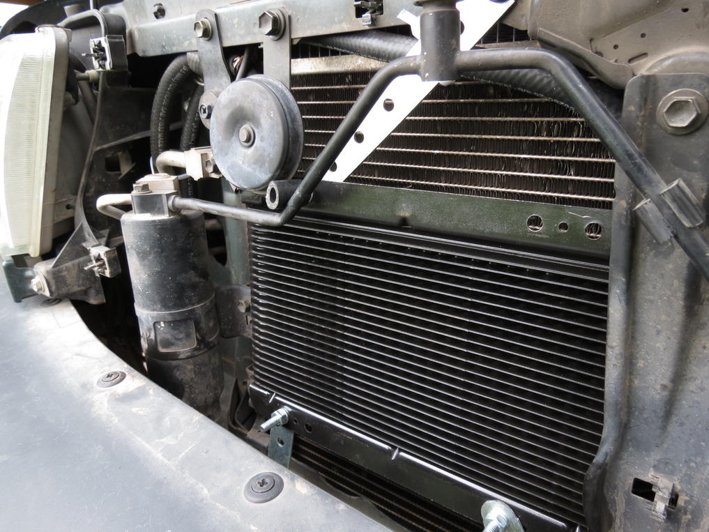

Thanks to the forum for teaching me about the pink milkshake. I never would have even heard about it otherwise! Today it was warm out, I got the cooler in the mail this week from Advance and installed it in a few hours. The hardest part for me was definitely hooking the new hoses back up to the trans. What a PITA! Anyway, I mounted mine with the zipties, with the ports down. No milkshake for me!
Thanks again to the collective wisdom of the forum! :cool:
