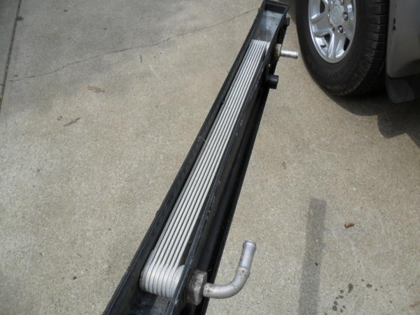

The dreaded factory trans cooler
Thought some of you may be interested in this, basically measures 1x15"
