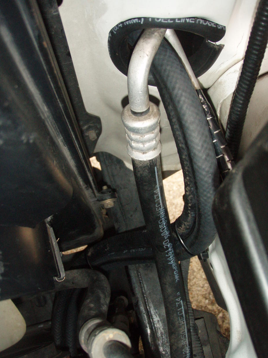

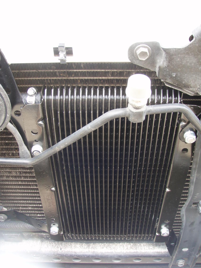

I just completed the trans cooler install yesterday. Thanks to Big Fish and others, I think I could have done this one with my eyes shut. :thumb3: I ended up using the brackets and once had them bent and trimmed, I shot them with 2 coats of primer and 2 coats of satin black. I ran the cooler lines through the same hole as the A/C lines. I had some 1/4" fuel line left over from the ISR mod, so I used it to line the hole and and protect against chafing. Same concept as others have done, just a little neater in appearence IMO. Thanks to you as well PDX for the recommendation to run water through the existing transcooler before connecting the recirculating hose. I can now drive around with confidence knowing I won't experience the strawberry milkshake!! Thanks guys!
