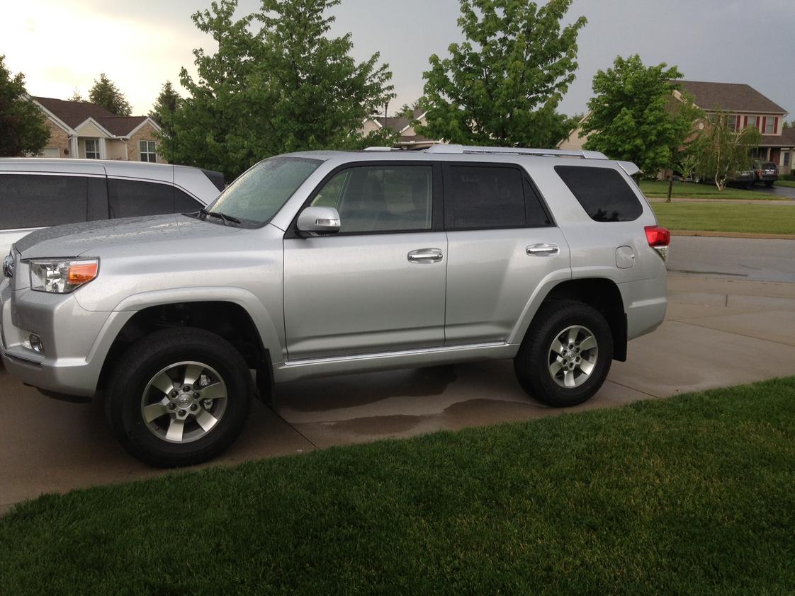

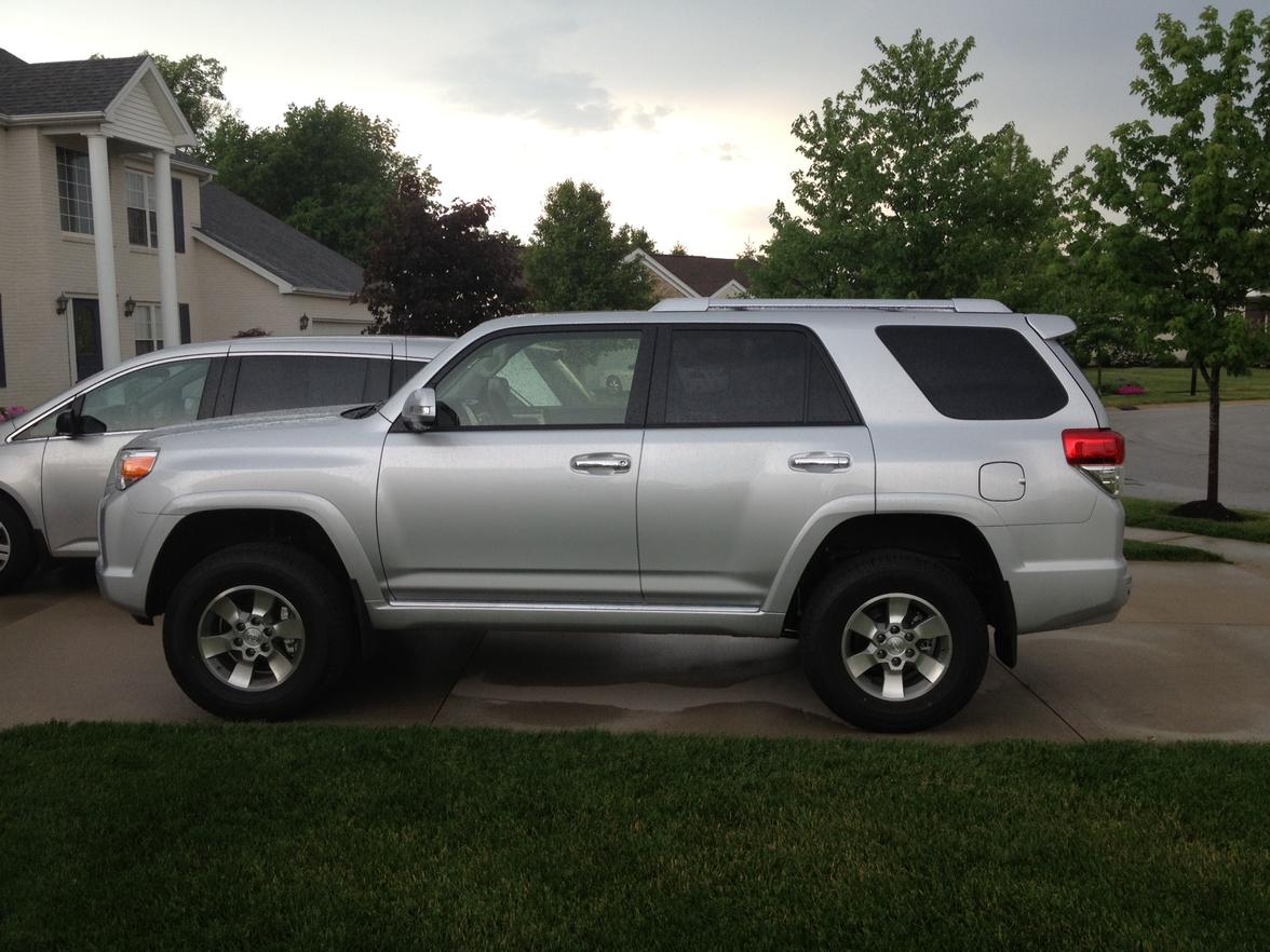

I decided to trade on 2012 Rubicon Unlimited in on a 2013 SR5. The Rubicon was an awesome vehicle, but a little to purpose built for my current needs. I decided to go with a 2013 SR5 with premium package and 3rd row. First mods....today I added front OME 884 coils and rear 895E coils. I maintained the factory shocks and struts. I am super happy with the results. The brake dive and corner roll is mostly gone, and the ride is still very comfortable. With the combination of coils, my fron to rear rake is now only 1/2".
Before

The lift is subtle but very nice! Any idea how much higher than stock height the front and rear actually are?
I achieved a full 3" in the front and about 2.5" in the rear. I'm sure it will settle some in the coming weeks, but should be good for a full 2.5" lift after settling. Next mod will be a rear cargo system with sliding drawers for use when one or both 3rd row seats are folded. Tires may be in the near future too.

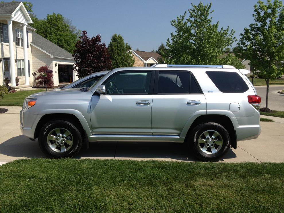

That is exactly what I'm looking for. Talked to Amber at toytec this afternoon who recommended this very setup (I said I wanted to level the runner, firm up the suspension, and lift is a bonus). Local shop wants $300 in labor though, plus the alignment. This sound reasonable to you guys or high? And where is the best place to buy this kit (ignoring the obvious toytec directly)? Thanks. And your "after" pic sold me, love that look with stock tire size.

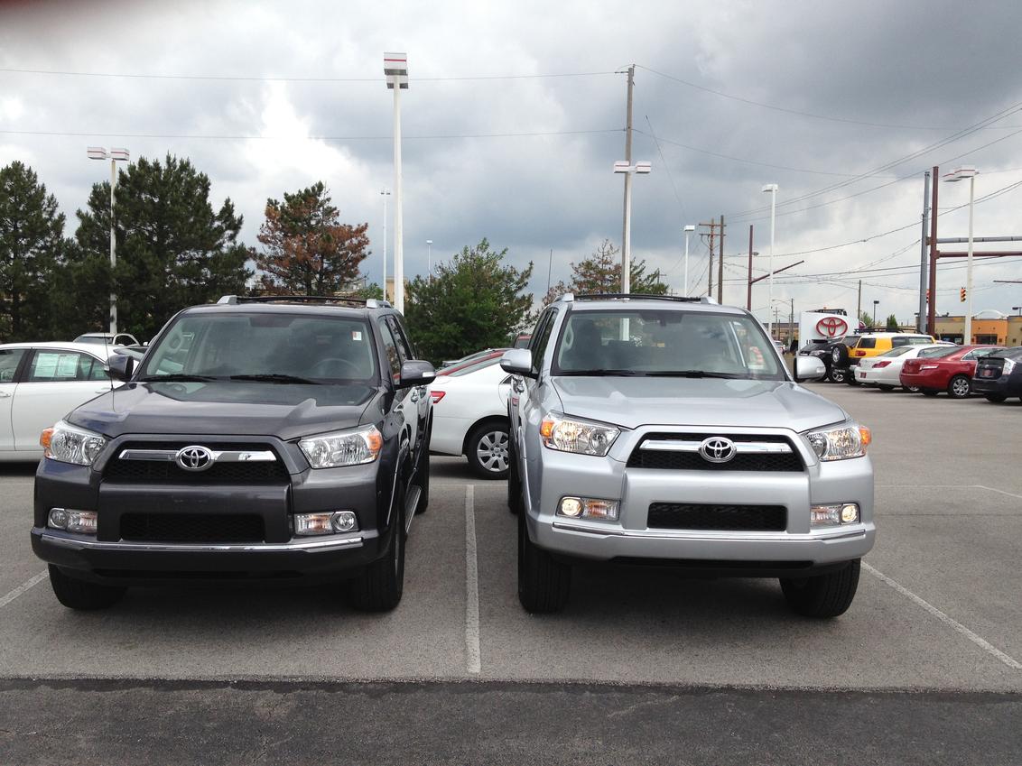

Here is a comparison of a stock 4R compared to mine with OME coils. Both rigs are on the stock P265/70/17 tires.
