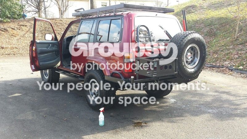

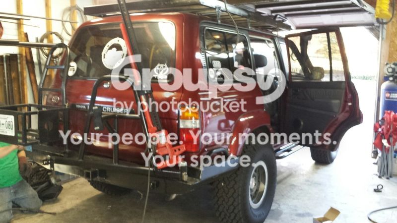

I found a local guy that's going to do my rear bar with dual swing outs and sliders for $1250. I think for that price I'm going to give him a try. I've seen his work and it looks great. Slee rear bumper and sliders would be $3200 plus.

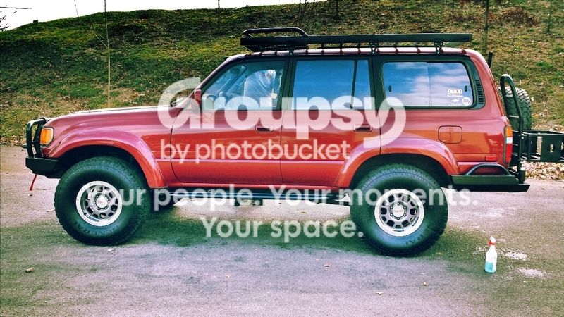

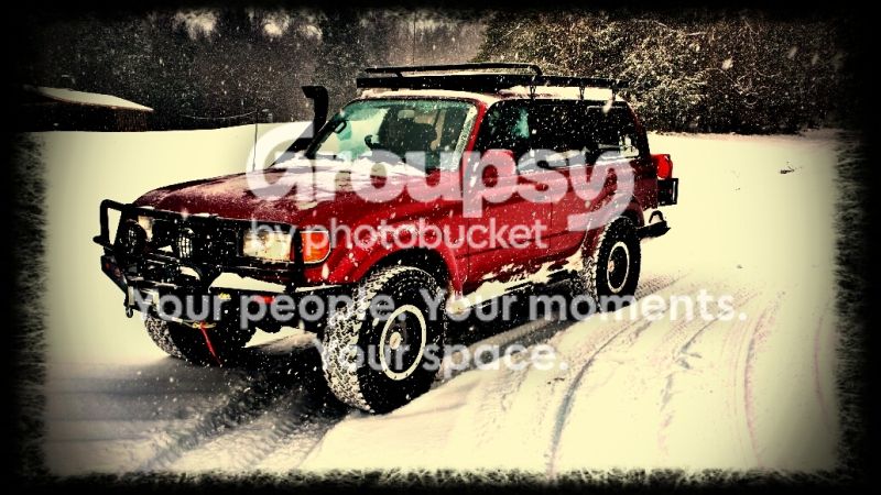

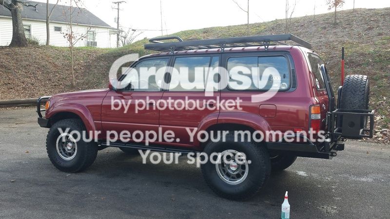

Sliders, roof rack, and rear bumper are done! It's taken about 5 months to get here but I'm close to what I want. Next up, re-gear to 4.88, that should be about it...............for now
Wow what a transformation. These LC's do look awesome once they are modded and beefed up. Job well done! Merry Christmas!
Your local guy looks like he turned out to be Great! Now you are making me want an 80 all over again lol.. I have to admit I like that rear bumper more than the Slee. I am still in the market for a clean Low mileage Hundy as much as I want an 80 I need something a bit more practical now since the runner is being built up. Any way Keep us posted as it's Never really done is it? :pop2:

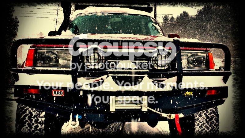

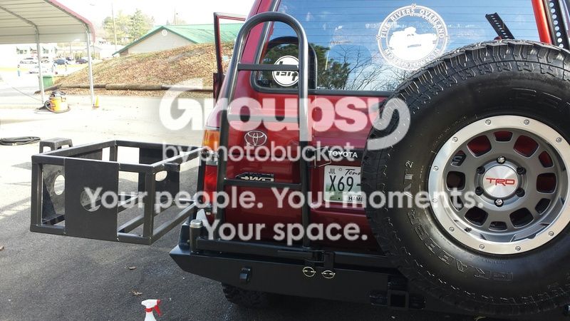

We tried putting struts on the swing outs but the spare carrier was too heavy for them so they lasted a day. Today we welded some T handle spring pins on and they're going to work great. Should have done that the first time.

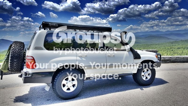

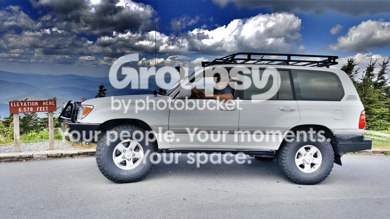

Well here's Land Cruiser #3 since I started this thread and the last one for a very long time. This one has everything I've wanted in a cruiser so no reason to look for another one.
Here's the specs

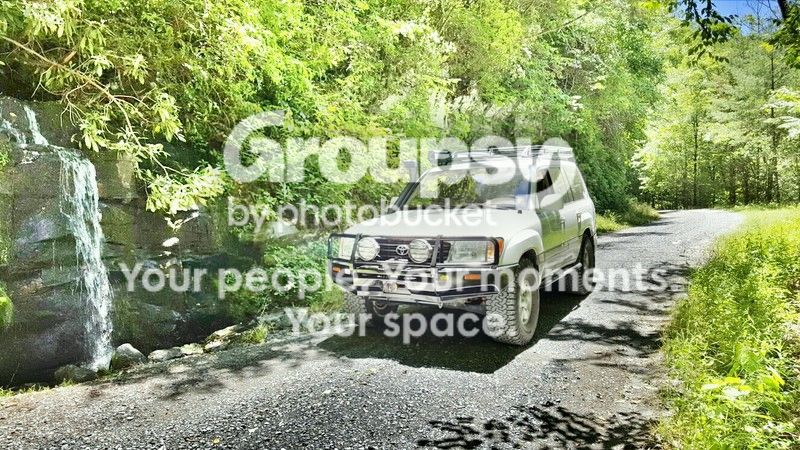

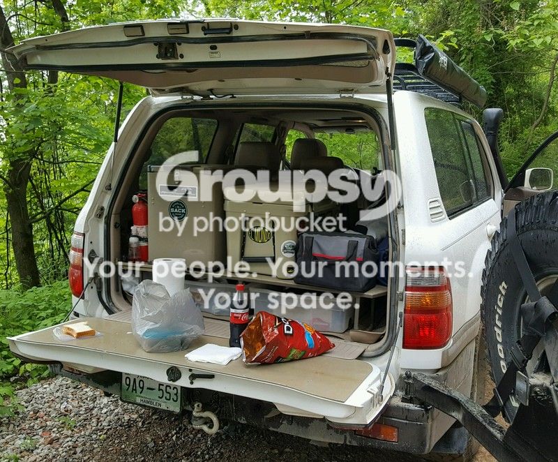

1999 100 Series, 98,000 miles when I bought it, came from Arizona so no rust, 2" OME suspension with Slee torsion bars, 4.88 gears ( amazing how much better the gas mileage is with the lower gear set ), rear e-locker, front ARB locker, ARB compressor, ARB front bull bar, White Knuckle Sliders, Warn HS 9.5 winch, Warn driving lights, Safari snorkel, TJM rear bumper with spare swing out, 43 gallon sub-tank, new 315/75R16 BFG KO2 tires, ARB frig, custom rear storage system, 15 gallon fresh water storage with pump and spigot, full roof rack, HEO awning, CB and Ham radio.
Here's a few pics from a recent trip to the mountains of western North Carolina and east Tennessee.
