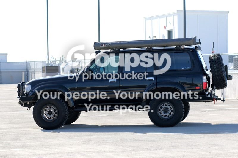

I found an 80 that's set-up exactly the way I want to finish mine. I even found a set of the TRD wheels that I'm going to try and get this weekend if the guy still has them They're black but I think I will paint them gun metal.
I think this one looks just about perfect

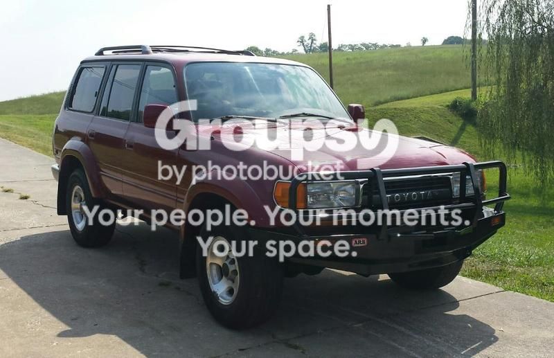

Those clear lens Altezza style lights have got to go... as do the chrome door handles.
I'd probably leave a WTF? note on his windshield.

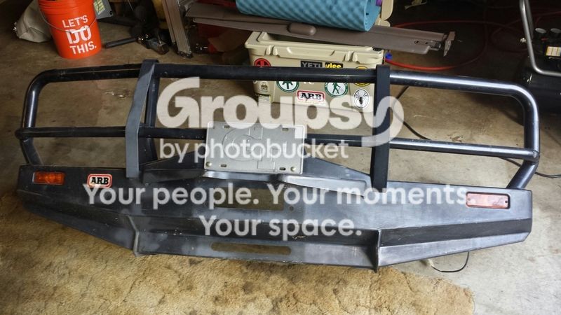

Craigslist find today, ARB winch mount bull bar. Still looking for a set of TRD 16" (Baja) fake beadlocks.

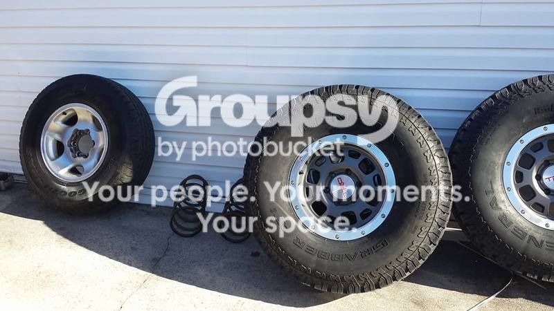

Got a few more pieces to the puzzle today, set of 16" TRD wheels. I'm going to paint the ring black and mount some 315/75/16 tires on them. I also have to order some 1.5" spacers from Slee for them to fit on to the hub. Also have to decide on and buy a lift before the 315's go on. Just more money.......killing my bank account but it sure is fun.

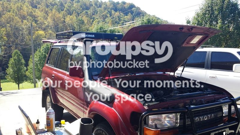

Haven't posted in a while but I've been busy working on the 80. Me and a buddy wound up doing the axles seals. It wasn't as bad as what I thought. I bought the kit from Cruiser Outfitters for less than $250 so even paying my buddy a little and buying the beer, I got it all done for less thn $400, plus I learned a lot myself. I put a new radiator in ( old one was shot ), did the pesky heater hose ( not a job I ever want to do again ), all new belts, hoses, new distributor O ring, oil pump cover O ring, front main seal, new hood latch cable, and new exhaust. I just bought all the parts to tune it up from a MUD member so will start on that this week. If anyone needs some Toyota OEM parts, I have a great connection at South Atlanta Toyota. Kyle saved me about $100 compared to what I would have paid at the local dealer. Also bought a set of WeatherTechs floor mats and since my front seats were shot and the motors didn't work on the power seats, I found all 3 rows from a part out on craigslist for $175. Believe it or not, they were in great shape and the front seats are manual so no more power seats to tear up. I took it to the paint shop yesterday to have the fender flares clear coated, had the hood painted, and the old ARB bumper will hopefully look brand new again. After I get it back I'm going to do the tune up and get to work on my mods. Will be ordering a new OME 2.5" lift kit this coming week, 1.5" SpiderTrax spacers for the TRD wheels, and then thinking about getting some 35" tires. I'm a little concerned about the 4.11 gearing with the bigger tires but I think I'll give it a try and if I have to, will bite the bullet and order some 4.88 gears. I would rather spend that money on a rear bumper but I may not have a choice. If I lived in an area that was flat I don't think I would have a problem but it's all hills and mountains here in east Tennessee. I'll post a pic tomorrow when I get it back from the paint shop with the ARB on.
I picked my rig up this evening from the paint shop and my buddy even installed my ARB for me. He painted the hood and blended everything in so it wouldn't stick out like a sore thumb. He even painted my pinkish colored side mirrors and clear coated my front flares that were starting to peel. $400 for everything, couldn't be more happy with it.

Mounted up and waiting on the lift. The 265/75/16's look a lot smaller now
You can see one wheel and tire took up most of the back of my old 4Runner but I did get all 4 wheels and tires in the back.
Well I did have to fold the seats down :)
I didn't realize how big the 315's were until I loaded them up. If everything goes good, they should be mounted on the Land Cruiser tomorrow.
