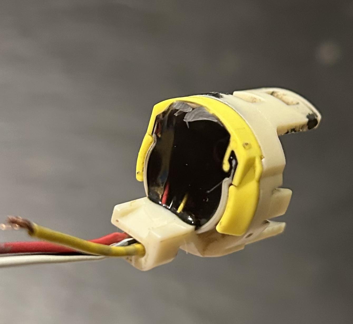

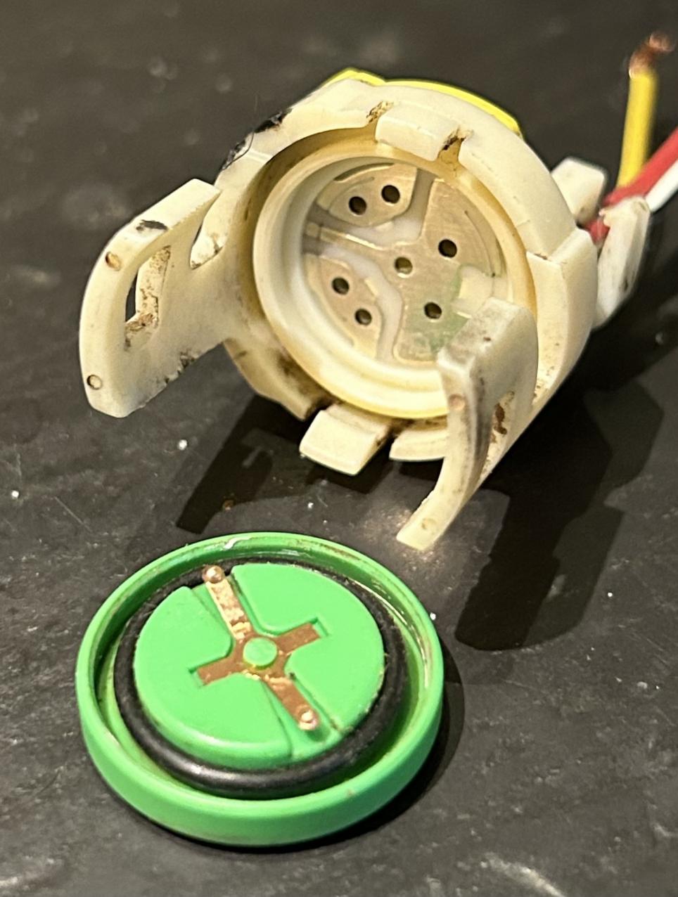

My 2000 4Runner started randomly rolling the rear window down by itself. My version of this problem also disabled window up/down from the tailgate key switch, and also disabled the rear wiper, so I couldn't just disconnect the window motor. Not that I was willing to do that anyway.
tl;dr A new rear window switch assembly fixed the problem. p/n 84830-35041. This is the electrical switch piggybacked onto the tailgate key lock cylinder.

- Reconnect connectors one at a time, and failure occurred when I clicked the key lock switch connector into place.
- Turns out that there was an 80 ohm "short circuit" in the switch between the "window down" wire and ground. Evidently this confused the ECU. To check this, pull the ECU connector and on the wiring bundle measure pin 9 to ground and 10 to ground. Don't do it with the connector installed because there's power applied to the ECU full-time, which may confuse the ohmmeter.

Like Brakleen, the key switch has full time power, if it is compromised, any excessive moisture will roll the window down on its own.

No doubt moisture could cause this. The switch has an O-ring that’s supposed to keep the contacts clean, but eventually everything leaks.
The green disk is keyed to the back of the lock cylinder and rotates to connect the up and down wires to ground.
FWIW, in my switch the short circuit was in the sealed part of the switch. It was there even after disassembly and cleaning.
