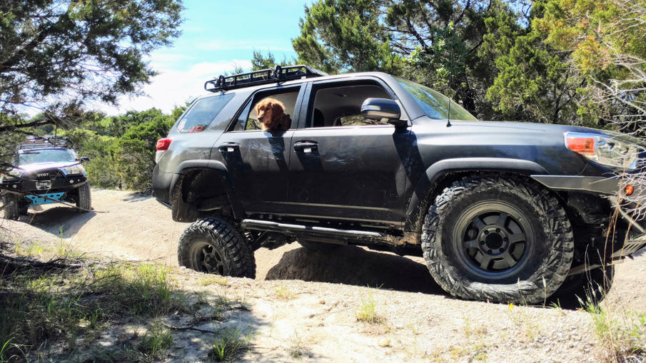

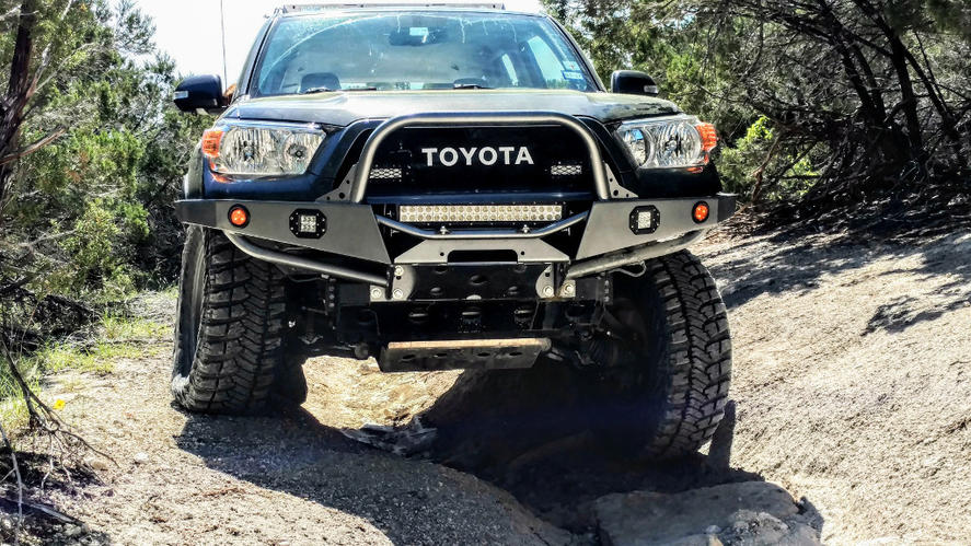

These pictures of my truck explain it. Do you really think my 3" lift is helping to clear the tires all when I'm on the bump stop?
I will agree a little rub here and there is not a big deal offroad and can be very annoying on a daily basis and a lift can help there.. but technically, they don't really clear bigger tires without the other changes.
Don't mean to sidetrack the thread.. but this is a common misunderstanding here.

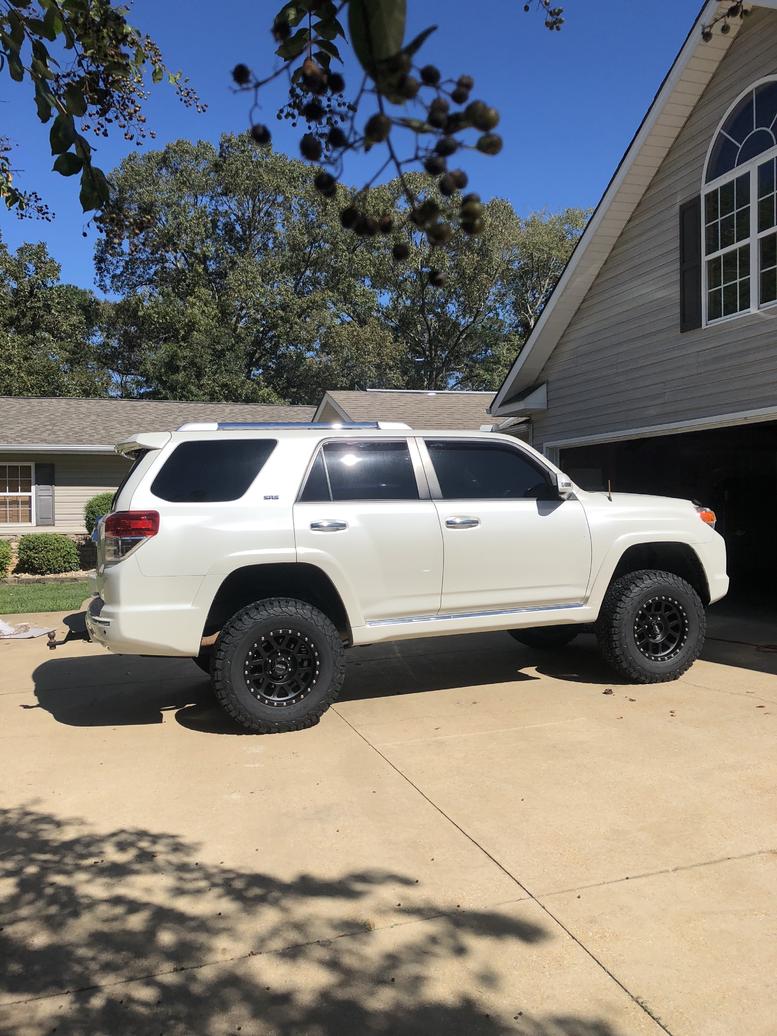

I can’t see this lift being 3 inches much less more than 3. Do you any advise on how to make it better? I’ve read some people put long travel boots on. Just kind of new to all this. I think my wheels are a 0 offset with 4.5 inch backspacing
There is no reason to make it better you are fine if in the 3" range (even a little over is fine).... I can't really tell from a picture.. But mine don't look all that different and have about 70k on them with no issue to speak of.
You can stretch the inner boot some and re-clamp, or use a high angle aftermarket boot... but it is all mixed reviews. If I were you I would not try to fix what is not broken. The only thing I would do is lower it a bit if it seems high in the front.
