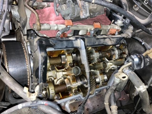

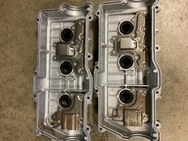

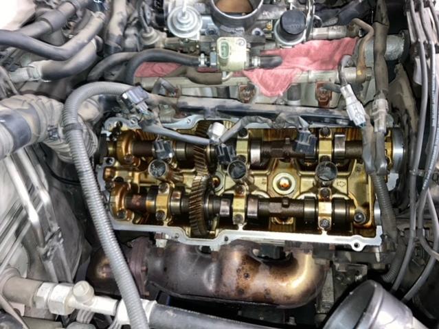

5/27/2022 203353 miles
-Replaced valve cover gaskets, spark plug tube seals, half moons, and cam plugs (Parts list in post #3) $146
I stayed late after work to reseal the valve covers. Nothing major to note except how clean the valvetrain looked when I pulled the valve covers off. Looking really good for it's age in my opinion. I put the valve covers in the parts washer while I cleaned the old gasket material/sealant off the heads and replaced the cam plugs and half moons. The valve covers cleaned up pretty good as well. Spark plug tube seals looked in good condition, but I already had new ones to put on so I replaced them as well.

Run some Rotella T6 for a few oil changes and it'll get even better...
That's mine after years of good oil service (maybe 270k total) and about 20k on Rotella T6.
I am jealous of how clean you got those valve covers!
-Charlie
[MENTION=319302]Bad Luck[/MENTION], Heads do look good, any idea what oil was used ?
Mine @200k had darker oil stains just as clean, PO religious with oil changes at quicklube with house oil non syn.
Got me to thinking, is it frequency or oil quality.
Did you use ultra sonic cleaner ?
[MENTION=139000]phattyduck[/MENTION], I like that after pic.
Been running T4 25k mi pulling covers soon so I'll get to see the results.
