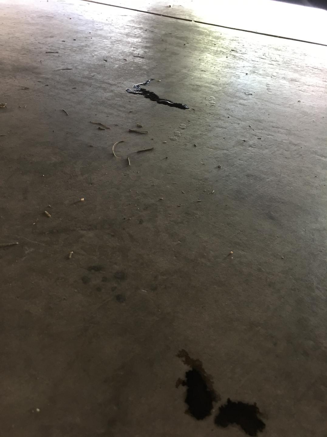

Took mine in for the 10k mile service this past Friday. Did them a favor removing the front skid and drain plug skid before I left for home since they were full of dirt and rocks. My garage floor now looks as such below.
First puddle is from the oil filter so I know this was changed. I'm fine with this. However, the second puddle under the drain plug is not right. I cleaned it up once, took her for a drive, and the puddle is back so they must have f**ked something up.
Will have to jack up the truck and see what the hell is going on. F*ckin hell. I changed the oil at the 5k myself very carefully following the write up on here. Knew I should have just did it myself than have to deal with this crap now.

Did some poking around and found that they failed to tighten the drain bolt. The bolt was on there finger tight. Tightened with my torque wrench, problem solved.
