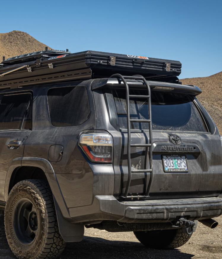

Running a Baja on my 16 Trail zero issues! People really overthink the installation, and go full retard. The key is having another person stand on the ladder while you clamp the longer lag bolt, then add the two shorter bolts at the bottom. Then on the top gap, I used a plastic shim and hammered down in between the gap to set the top plate flush against the hatch. I’m not running heavier struts, and I like the visibility as the Baja sits more to the left than traditional ladders. Total installation time was 20 minutes.
