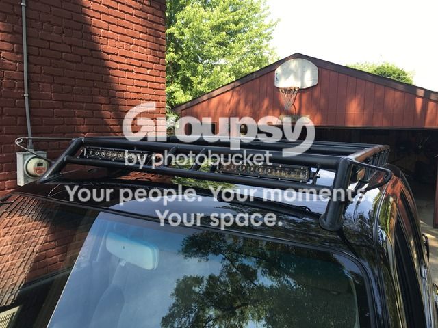

Got a little more done on the roof rack changes today. Welded a new tube section in between what was left of the lower tubes. So now it goes straight across.
Then I welded in the new light mounts. Here is what the 10" lights will look like:
I still need to add the two vertical tubes that will go in between the two lights.

Finished up the fab work on the revised roof rack. Got the 2 vertical pieces welded into place:
Then I repainted the modified areas:
Just need to mount the new lights, and reinstall the rack.
Roof rack changes completed and lights installed:
Compared to before:
Can't wait to get some output pics of these new lights.
