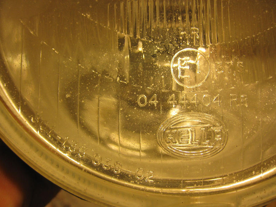

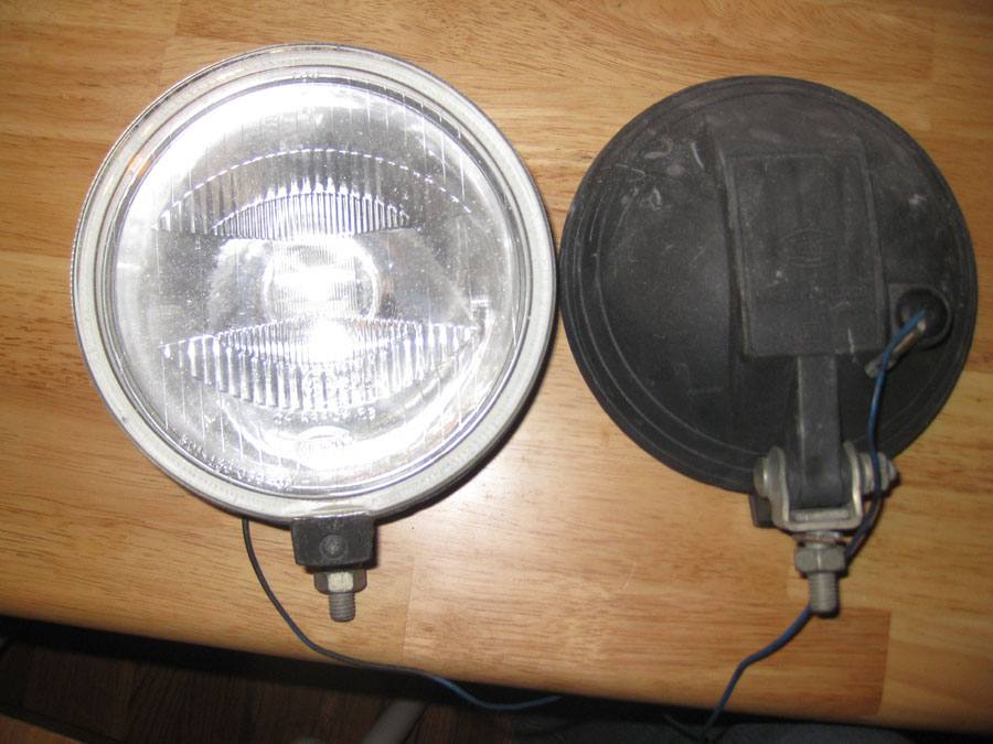

I wanna add some HIDs to these if I can. Can you only do it with the fog 500?
I don't know if these are the fog or driving lamps. Can anyone identify them for me?
If I wanted to do it I need a 35w HID, right.

Those definitely look like 500s, but not sure what pattern they are.
The reason the old fogs are the best is because the glass is what determines the pattern, not an internal reflector. Glass handles the HID dispersion better.
The 35W bulb in the kit from DDM should fit those, but you'll have to drill the 7/8 hole in the back for the grommet. It's a cake modification and install, and well worth it.
I bought a pair of new, old style 500 fogs with the intent of doing the HID swap. For kicks and giggles, I plugged them up with the stock 55w bulb before pulling them apart. No comparison to the HID.
The glass pattern creates a near flawless, hot-spot-less throw of amazing light.
Yeah, I was trying to find out what they are(fog or driving) using google, but it looks like there are several lense patterns produced for both the styles over the years of production.
And yes they are 500s... I know that much.
It doesn't matter if it's the fog or the driving beam. Both will work.
You can use either a 35 watt or 55 watt kit. The bulb will be the same size either way.
