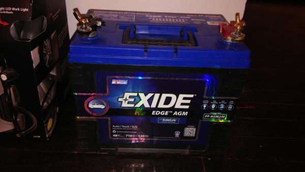

The only other battery that I would buy is the Exide Edge. It's slightly less costly, but every bit as capable as the Odyssey. My wife has this one in her Camery. She was having an electrical issue a few months ago when NJ temperatures (20 Deg F) prohibited me from resolving it; the radio was coming on at random so when she got into the car in the morning she'd often find that it was on. One faithful morning she got in it only to find that her "Dyna-last" (Autozone) battery was completely dead! I had to disable the audio system until I could kneel down in the driveway to go after the cause. In the meantime, that experience had her spooked so she wanted a brand new battery until I could fix it... I chose the Exide Edge! Take a look:
rigtec-albums-%26quot%3Bgentilmen+prefer+redheads%26quot%3B-picture41149-20160112-201931.jpg
rigtec-albums-%26quot%3Bgentilmen+prefer+redheads%26quot%3B-picture41150-20160112-201951.jpg~original
Both of these AGMs (@900 CCA, 125 min res 'mine'/@710 CCA, 120 min res 'Hers') are more than capable of all you put them through so buy with confidence!

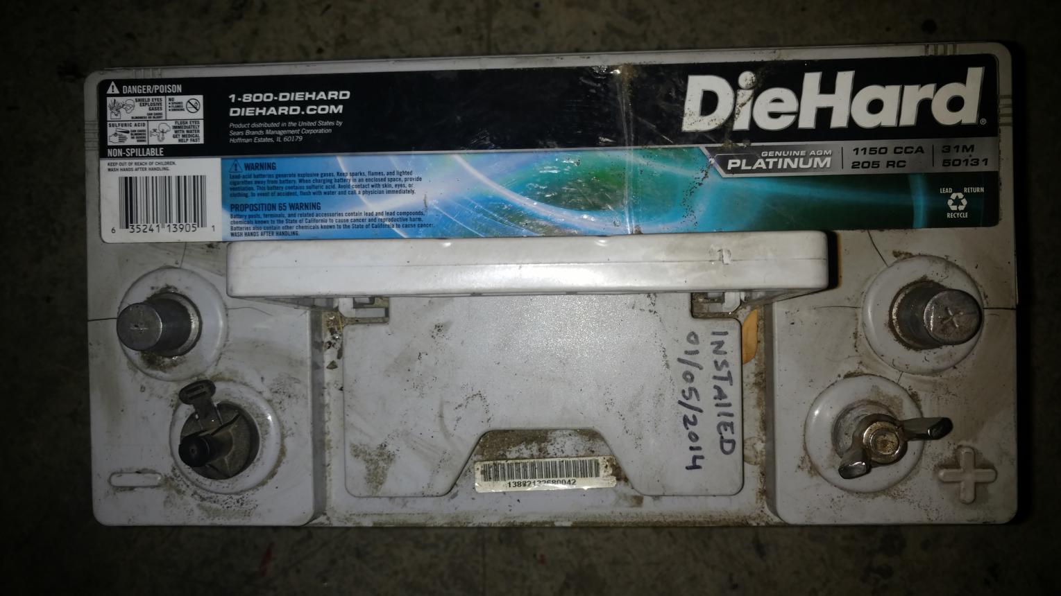

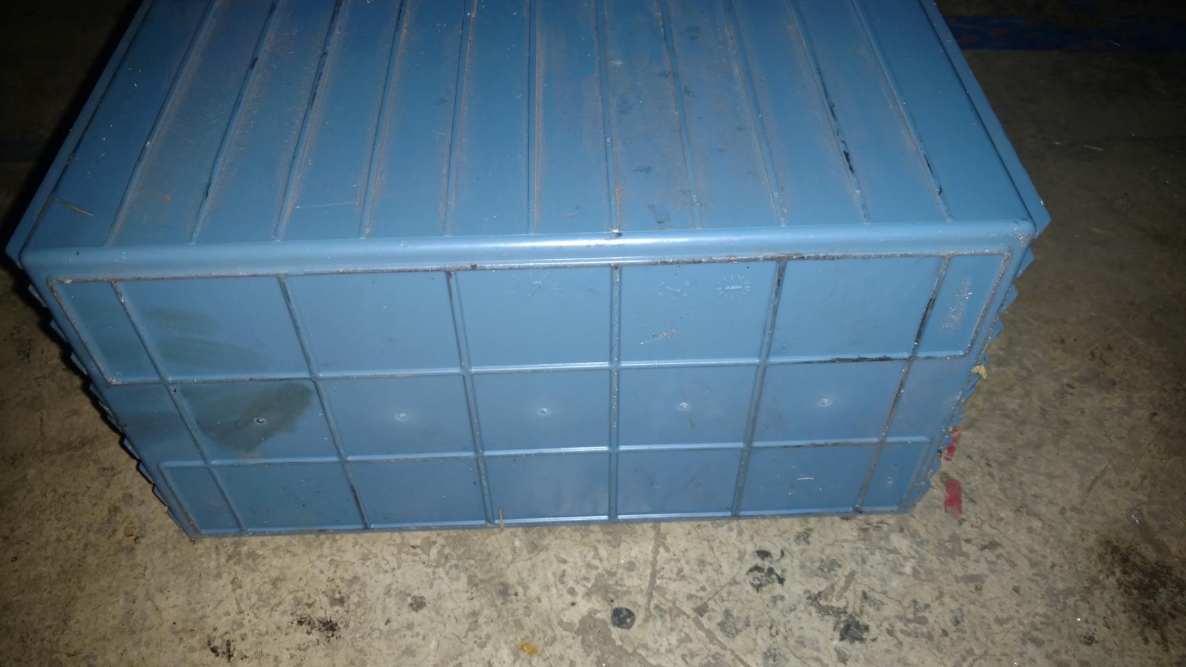

Just to close the loop here. Pulled out the 31M and found a small puddle of fluid under it and cracks around the poles.
I guess I now know for sure what was causing it to lose power!
