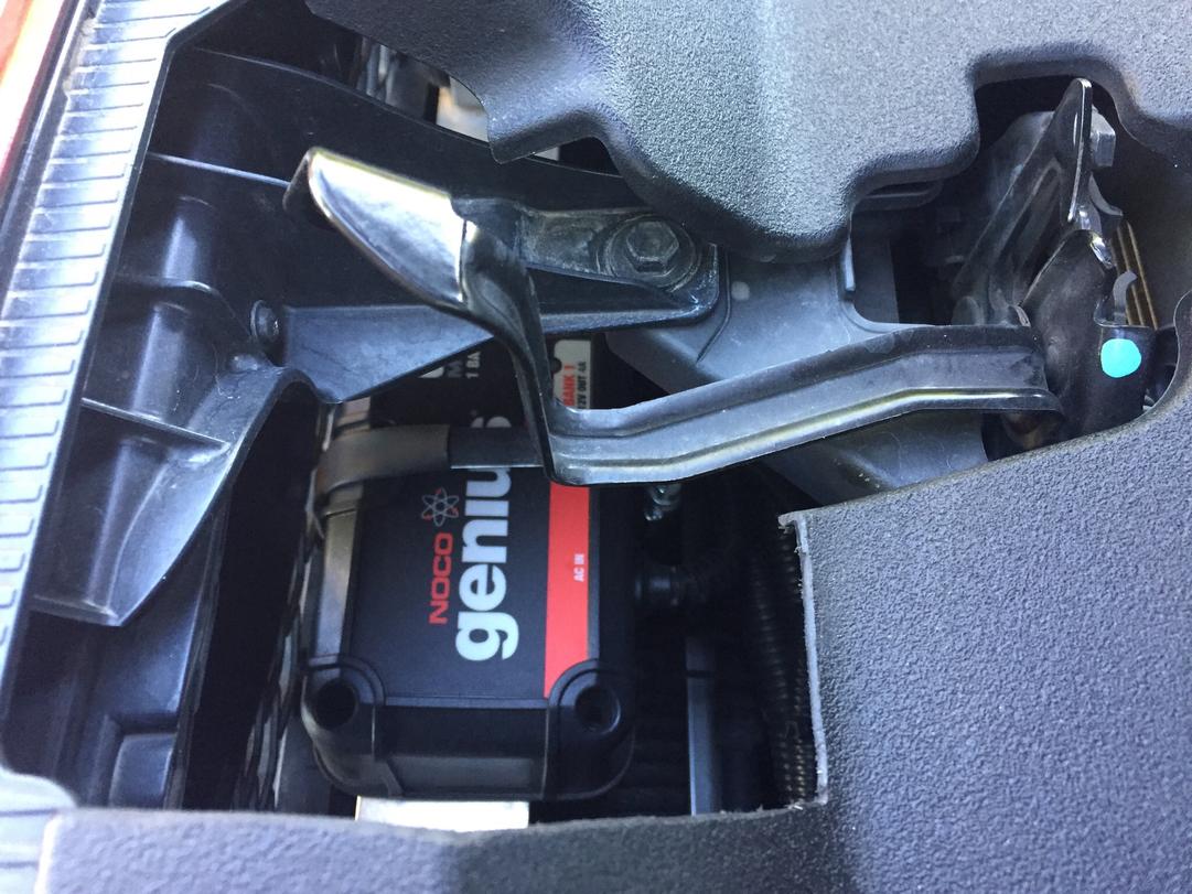

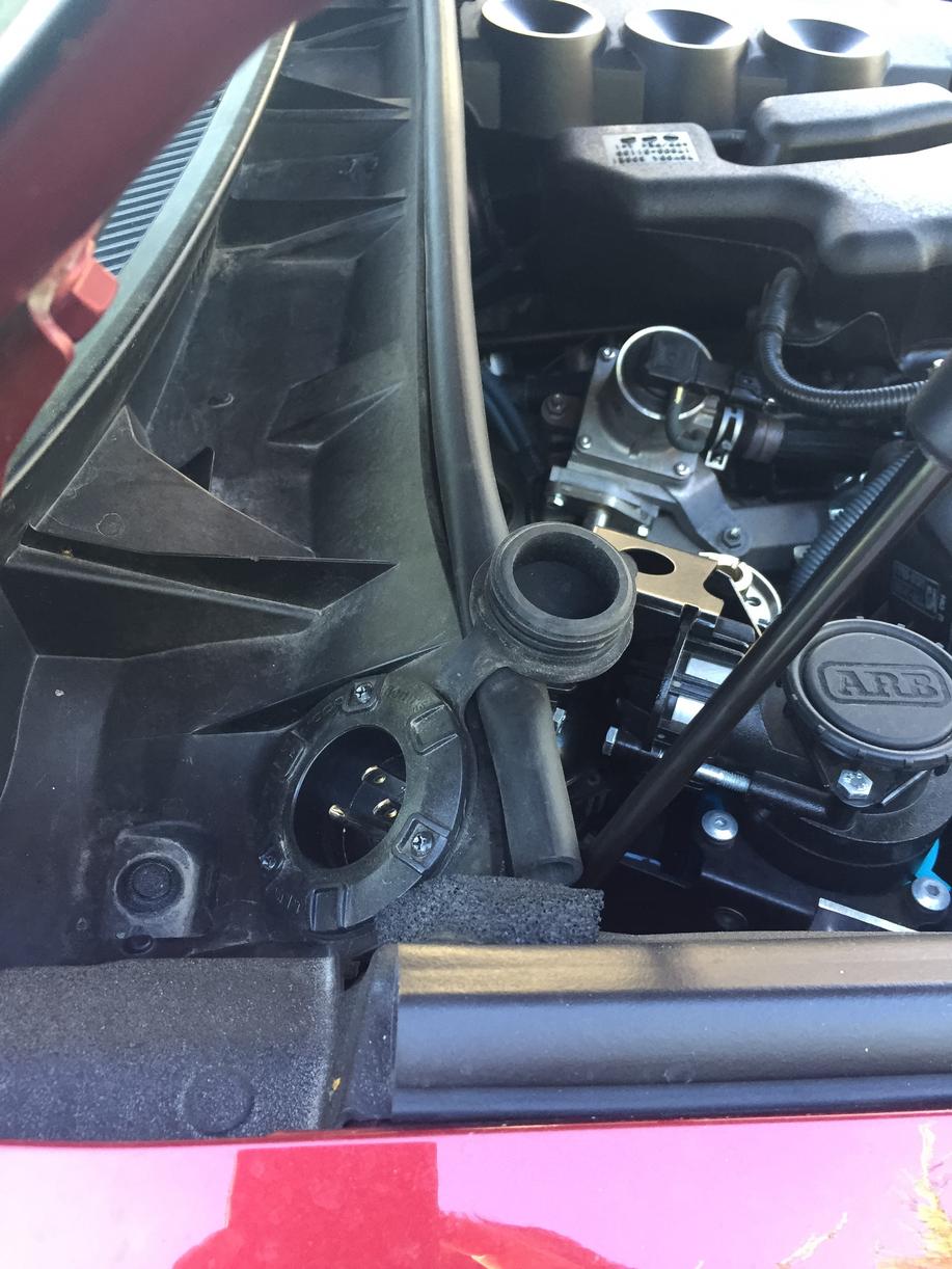

Where do you have yours lines mounted, can you share a photo? Any additional information will be helpful to me and others.

Nice, amazon has them for a 100 bucks.
Sure! It's mounted on the same piece of aluminum my lights are. It sits right behind the grill (it is IP68 rated). Lol you can see the charge status through the Toyota emblem.

And the plug...up by the firewall, bought it separate, it is NoCo and right around $10. Apart from drilling a hole in the bumper cover this Seemed like the next best location. The antenna hold the extension cord when the hood is closed. You do have to open the hood to plug it in, unless you got barbaric with the plastic shroud
(On an iPad, only lets me post one pic at a time)
