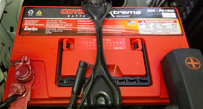

Forgot to add, the 1500 will require a spacer as it's shorter (but longer) than stock Spacer for Group 34 batteries*| ODYSSEY Batteries, no mods necessary bolts right in.
