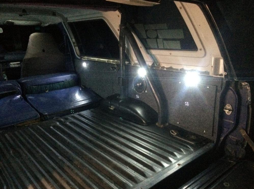

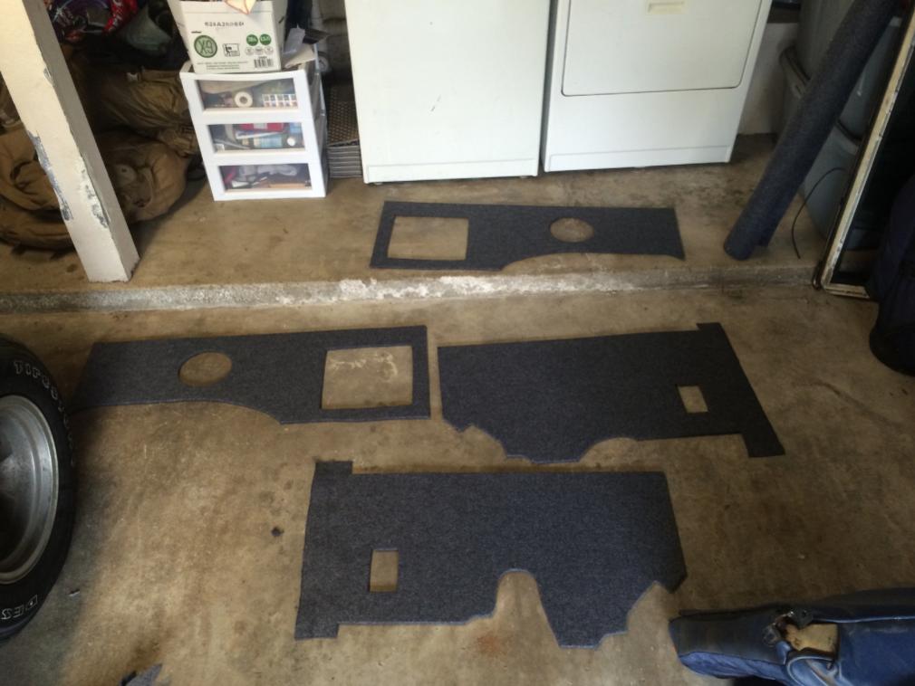

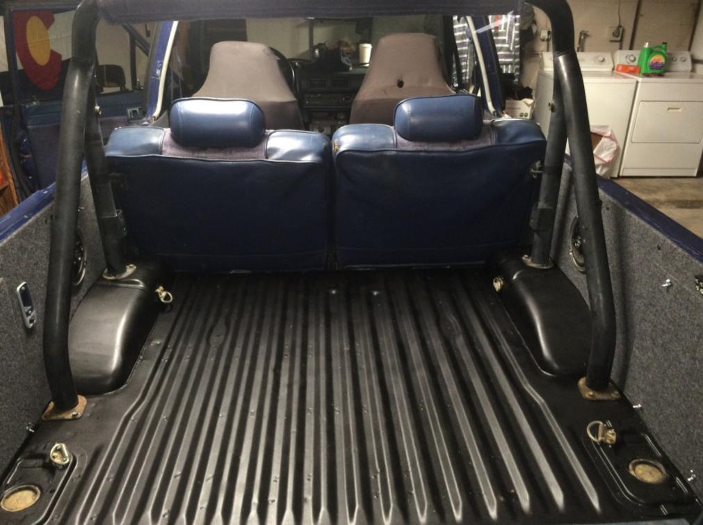

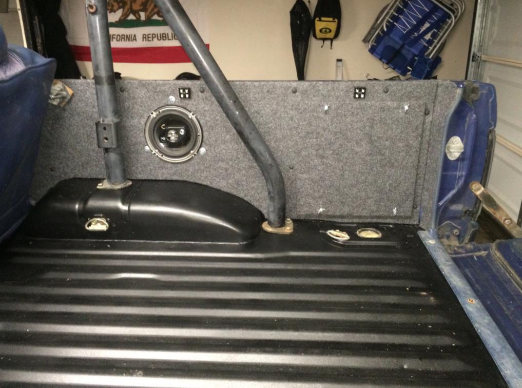

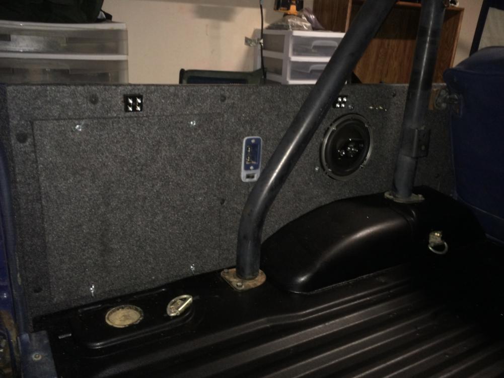

I was sick and tired of the old plastic panels rattling terribly on the road, so I made some new ones. The wood is 3/16" hardboard. I took a square chisel to the round peg holes so the plastic fittings wouldn't spin when I screwed the screws in. The hardboard holes have rubber grommets to 1. reduce vibrations and 2. I can fudge the holes a little bit. I'm happy with how it turned out. Next on the list, seats! (oh and cleaning/painting the roll bar) More pics here:
