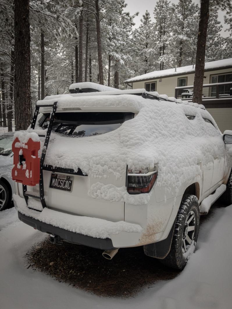

Fast forward to this weekend, I just put a single 2 gallon fuel tank on the back
With fuel in the can, the struts won’t keep the hatch up.
I have to go back to using a visegrip on the strut shaft to keep it up
I need to get two 2 gallons cans on my ladder so I need a strut setup that can handle that kind of weight.

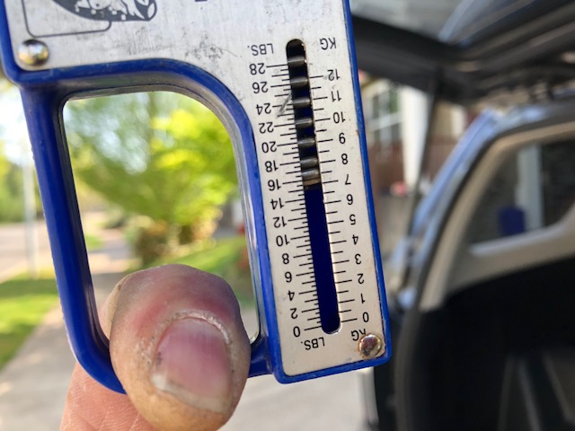

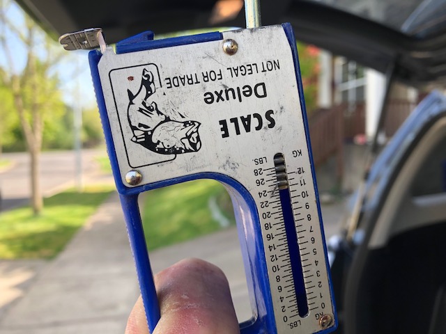

These are what I got and you can see my testing in the pics stock vs. these 6156 struts, went from 15 pound pull to 24 pound pull to close door, working great.
If you go too strong they will be a pain to pull shut.
