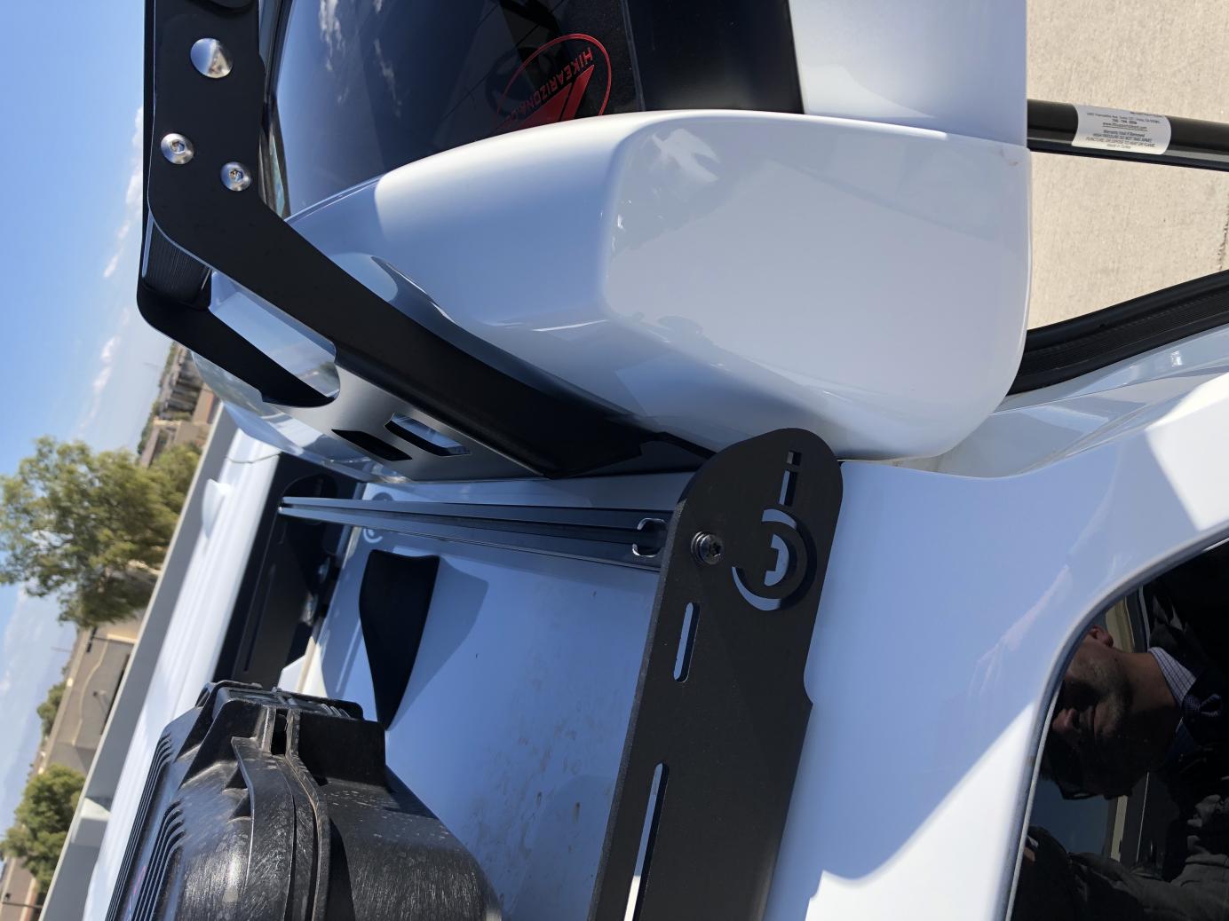

Hi there! First time posting in a forum so hope I'm doing this correctly. Nice build! Do you mind telling me which rack you have? I'm scoping out the Prinsu (full or 7/8) and the T.M.T. for their low-profile specs and I'm 100% set on the c4 ladder. How do you like it? I was curious how the racks I'm looking at and C4 work together - any issues when you open the hatch? Any rubbing or overlap? Did you add any additional side steps? Thinking about 1 or 2.
Zero issues with the prinsu and the c4 ladder
And I am very happy with both the full prinsu rack and the c4 ladder
Both are excellent and do what I need them to do
Thanks for the picture. Perfect fit. I love the slim lines on these- I can't stand the bulky tubular designs. I have a Prinsu Full shipping on Thursday and I should be ordering the ladder soon. Talking to C4 about racks they confirmed for me that Prinsu is the way to go over T.M.T. You're the first person I could find with this set-up! You have me more pumped than I already was!
