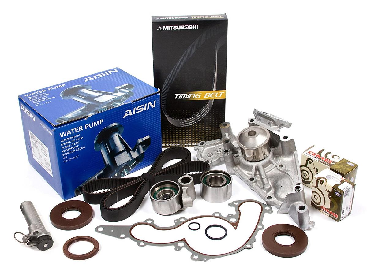

What are the brown things in this photo? Are they the cam and crank seals?

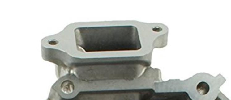

Does the Aisin TKT021 kit come with a gasket for this part of the water pump? I have noticed it's in the photo of some kits but not in the photo for this TKT021 kit.
https://www.amazon.com/Aisin-TKT-02...&qid=1489620328&sr=1-1&keywords=aisin+tkt-021
That's where you use the JB Weld, there's actually a small trough to bead it into.

DO NOT USE JB WELD! Permatex fipg. I used water pump and thermostat, others have just used ultra grey/black. Either way. NOT JB WELD.
You're correct, those are crank + cam seals. I wanted to do mine as well, until I figured that's a shit ton more work and they're bone dry as of 318xxx miles. I figured, if they aren't leaking now, I'll wait until the engine rebuild. It was a huge struggle for me not to do them but i left well enough alone.
Technically there isn't a gasket for this part. FSM said to use FIPG into the mirror part, there's a groove for the FIPG. But, the Ebay listing does show a gasket for this area and it should work out fine as well. The Amazon kit doesn't show this gasket.
Do NOT use JB Weld, that's the dumbest thing I've heard.
The water pump doesn't need any FIPG or goop of any kind. There wasn't any from the factory and no need to add any. The supplied water pump metal gasket with rubber is plenty sufficient. This isn't a domestic engine, tolerances are very tight in this engine.
I ordered the Amazon kit and will be ordering that gasket from Oreilly's.
