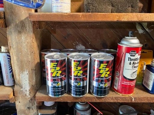

Just a picture.
My collection of BG’s 109 product.
