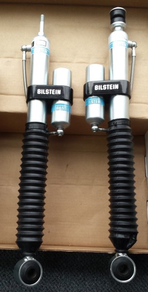

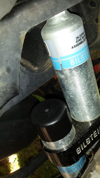

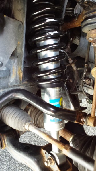

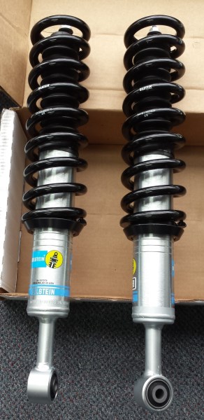

Several of us are running Bilstein 6112 front, and 5160 rear............
http://www.toyota-4runner.org/5th-gen-t4rs/183858-when-will-bilstein-6112-released.html
My setup, fronts set to forth ring which equals 2.5" lift, rear has Daystar 1.5" spacer. I was very impressed with the change in ride, less harsh and more controlled. IMO our vehicles (trucks/SUV's) should have been equipped with them from TOYOTA!

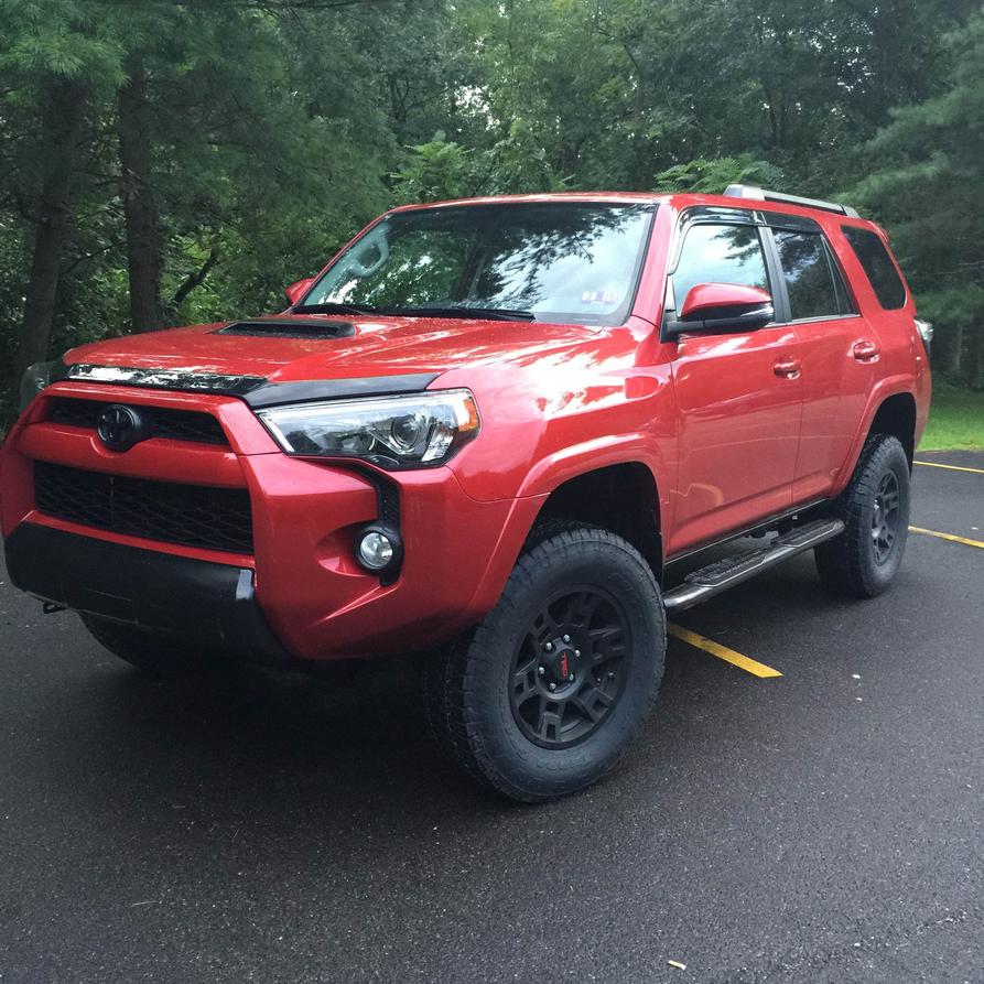

Decided that I was going a bit overboard and just went with the ReadyLift 3"/2" leveling kit and 1.25" Spidertrax.
My Nitto G2's should be here tomorrow. Stock 265/70's.
This setup won't help the ride quality but it'll look nice!!
