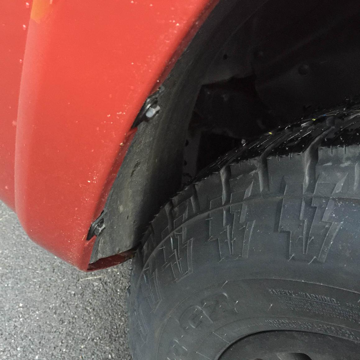

GGRRRR........I don't understand why I'm getting such bad rubbing!!.......stock size tires and 3" front lift........It must be the spidertrax but I really didn't want to shave any plastic from the fender well
Rubbing on the mud flap on the front tires? I have 265/70 r17 BFG KO with roughly a 3" lift and spidertrax. I had to have the caster set to 3.6-3.9 deg to not rub the mud flap. If it is less than that they would rub a little. I went ahead and trimmed the flaps to avoid it altogether. If I put on 33s I will have to do a body mount chop. Just the nature of the 4th gen t4r.
No, the front bumper and fender lining, in front of the front tires.
Probably just a typo, but I'm referring to a 2015 5th Gen.
That is the exact spot on the front bumper they trimmed on the Pros at port. They were apparently rubbing there as well.
I'm on 285's & 4.75"BS & LR UCA's. I pushed the fender liner forward but my front bumper is rubbing pretty good on reverse. Seems like that lower section on the bumper is completely unnecessary along with the gigantic body mounts.
