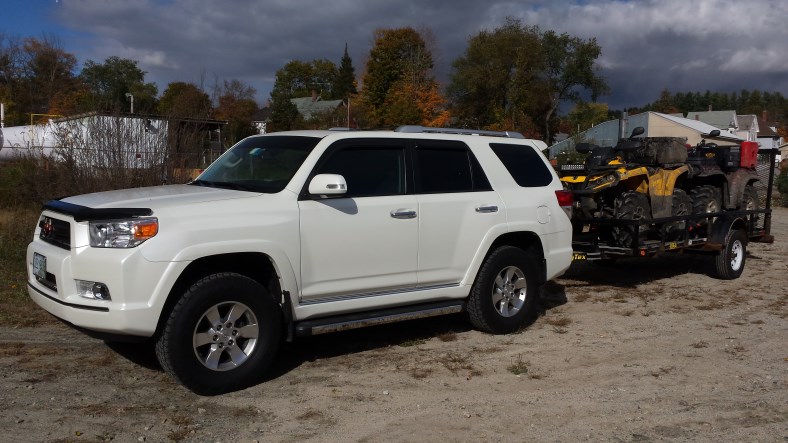

Does this count as "offroad"? And BTW, trailer is lifted too :eyebrows: :lalala:
So it's been a few months now since I had the 3"/2" spacer lift installed.........I'd have to say I love the stance and ride height.......and ReadyLift was true to their word about it not changing the stock ride.....Mostly.....it does feel like the rear hits the bumps a lot harder being that its a 2" spacer for the coil and stock shocks. Feels harsh.
With a rear 2" spacer you are actually topping out the factory shock when it tries to extend over bumps. Replacing with aftermarket rear shocks designed for a 0-2" lift would eliminate the problem. Something like Bilstein's 5100 or 5160 to name a couple.
