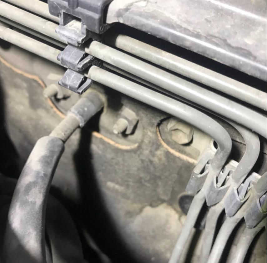

Thanks for the video, that looks like a great spot too. I have a 99' SR5 and that entire area is covered with firewall insulation (see pic), which leaves me with a couple of question
- do you know if there is still a grommet in the 99's?
- if there is, is there any harm in removing the insulation in that area for the grommet? (ie, is there something inherently different that makes the 99+ models run hotter in that area?)
- Will the temps in that area be significantly hotter? Sorry about being a newb but I don't know how hot it actually gets in there and my wire says it's rated to 150 C
Thanks!
Thanks!
You should probably only remove as much insulation as you need too. I think it's to reduce heat transfer as well as provide some sound deadening. I don't know if the 99 has that same grommet hole. If it doesn't, just do what the other guys suggested and drill your own hole with a hole saw.

So I found that there is a grommet behind the insulation. I'm still considering drilling a hole because the grommet on my truck would pretty much come all the way out and touch the engine unless I cut it down some.
