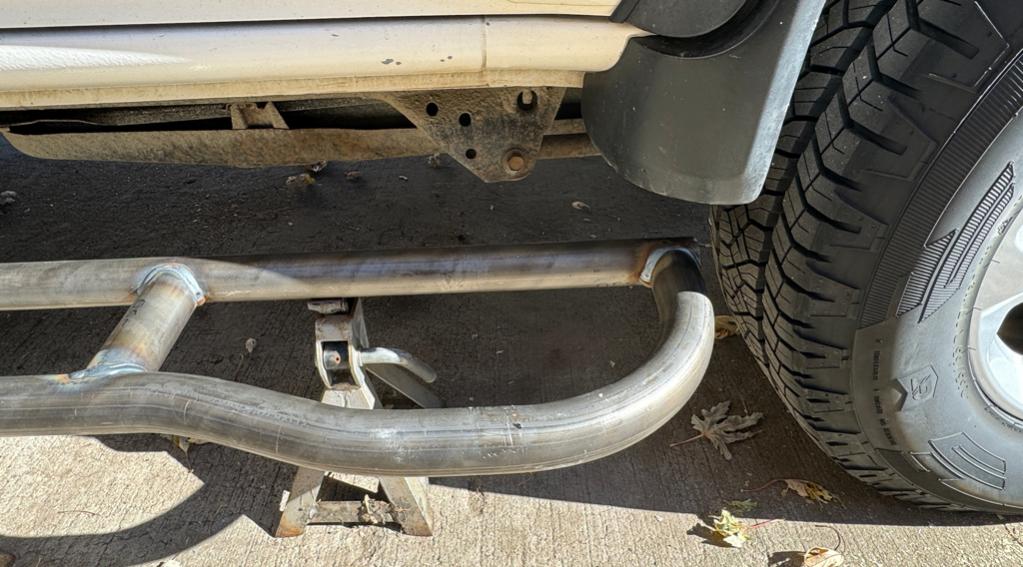

Just giving my input here. I don’t know about bolt slider so I’ll tell you about the sliders I had installed.
I bought the All Pro sliders for $310. I had them welded on by a mobile welder for $300. I probably paid “too much” for the welder, but I’m happy with the results. Strong, sturdy, and looks great.
Link to sliders:
https://www.summitracing.com/parts/AOF-AP-306627

If you can find someone to weld them on 4xinnovations makes good sliders that can be ordered with or without kick outs. 1990 - 2013 Toyota 4Runner Off Road Rock Slider
I would recommend the kickouts even on a street truck. Makes it super easy to stand and clean the roof, or for rear passengers to step in.

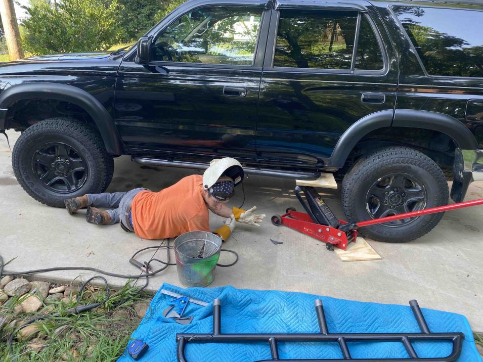

Xo Fab for me. DOM tube came as a kit half welded. I had to cut and weld the horizontal mounts to both the slider and to the frame.
I ended up changing my mind and shortening them. I originally measured when I had spacers on.

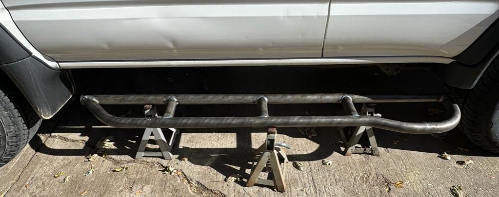

That's what I'm doing this weekend to the just arrived 4XInnovations DOM sliders, I figure that I'll be shortening them 5-6 inches -
I'm also regretting not angling them... But, they work really well in the rocks, both sliding against /over and kicking the rig/rear out.
If you play in the rocks at all, have a good strong rear bumper, I use 4XI plate bumper, and add rear hoops to keep your rear quarter panels & taillights minty.
