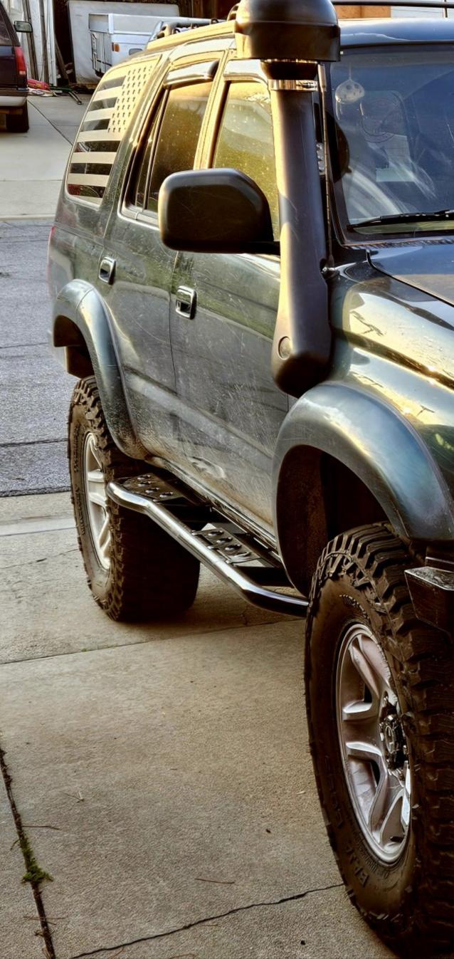

I also went with 4xinnovations, square tube w/dom and step plates. Great quality.

Any strong opinions on whether to go angled or not? I like the angled look but wonder if you can step on them to get to your roof? Any opinions?
Mine are perfect for roof access. washing waxing, loading on the kayak/rod holders..

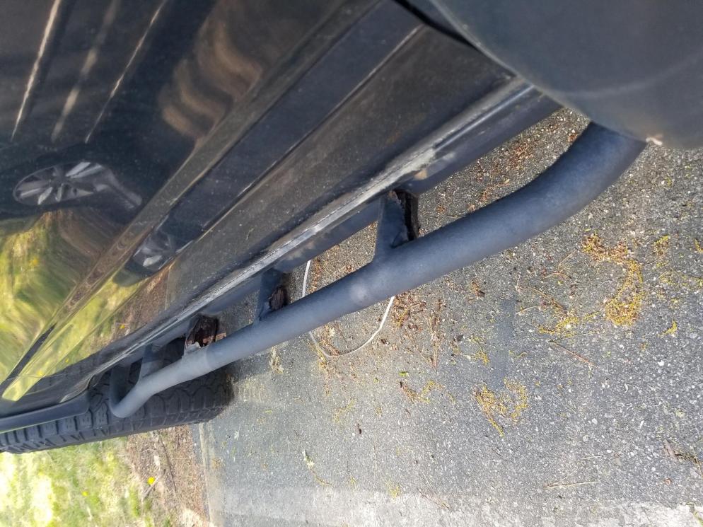

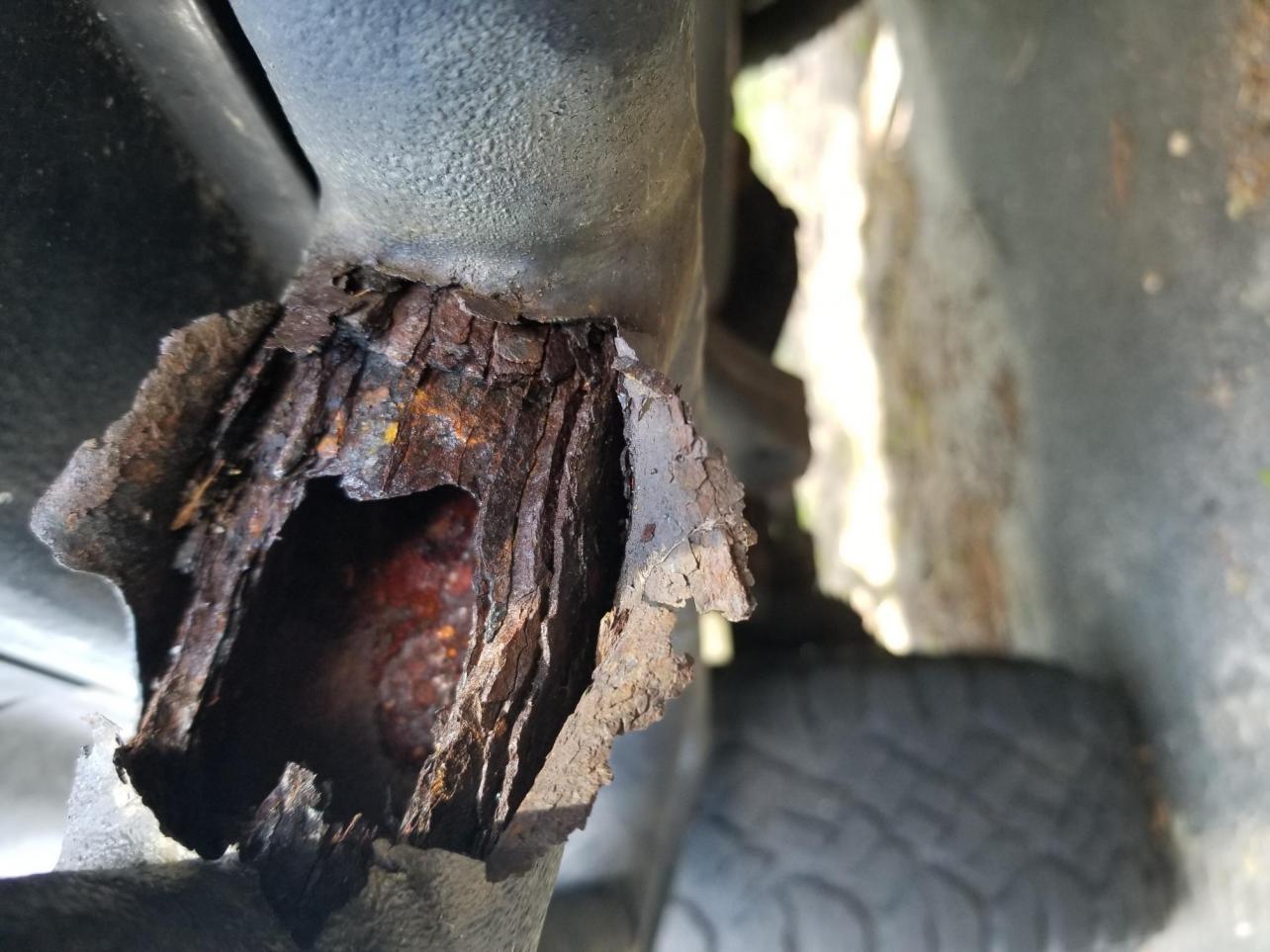

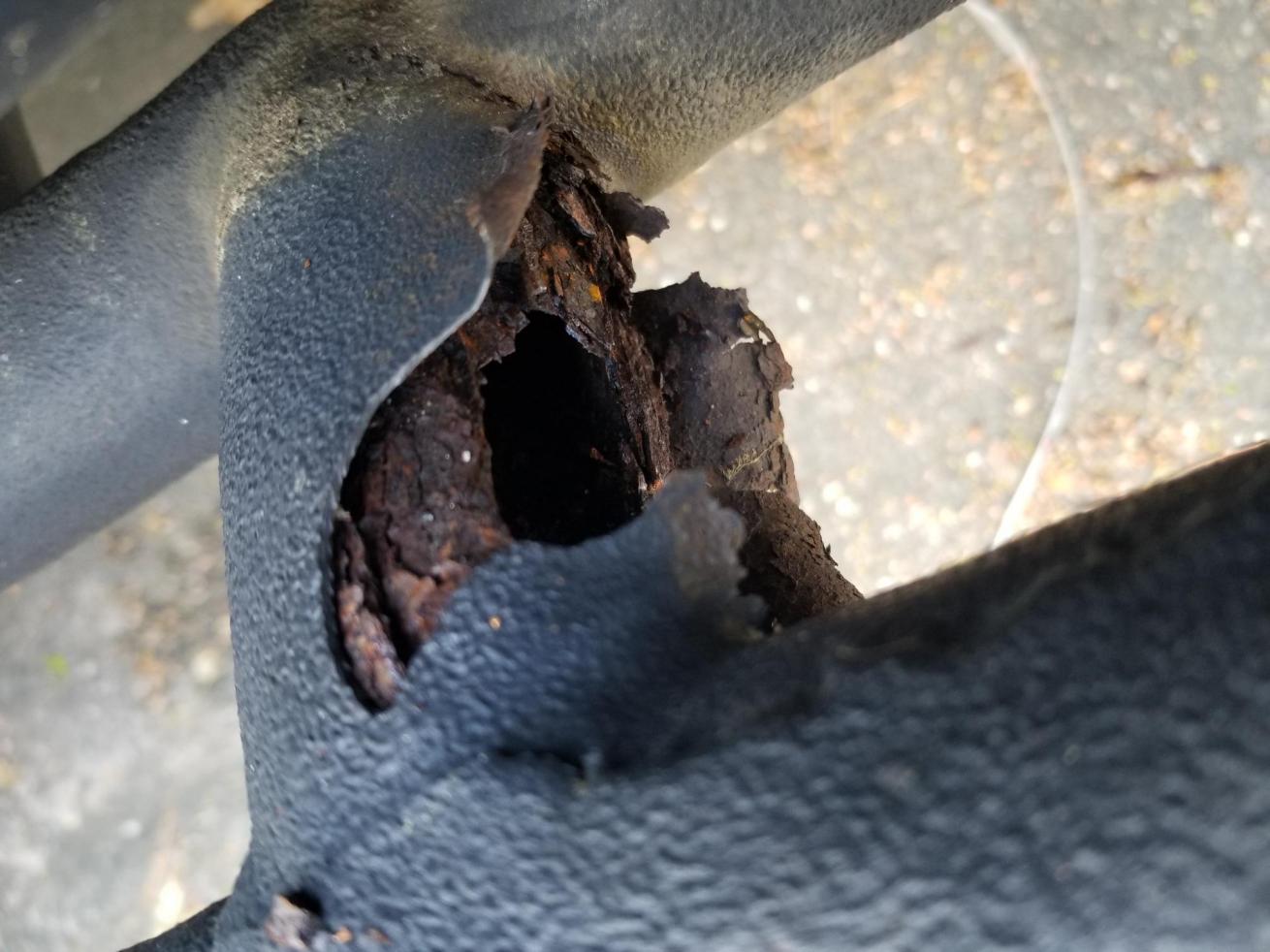

Just get quality..... remember you get what you pay for. I can't blame this on the manufacturer just on the place that did the prep work before spraying on the subpar coating.I thought i did my Homework.
