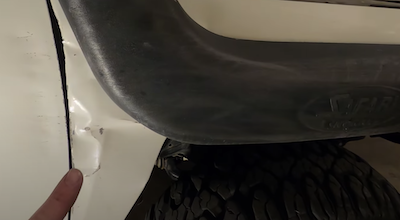

So Safari and Dobinson is a look, I get it, it's very traditional. The TJM airtec snorkel is very polarizing. The TJM has one thing going for it, it's low profile. I know thats not what your going for, but when you hit that monster flexing bicep on something your quarter panel and door may do some of their own flexing.
