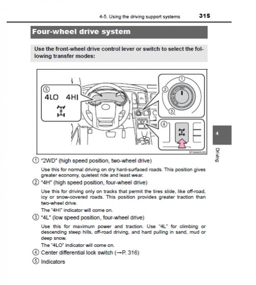

It could have 2H, 4H unlocked, 4H locked, and 4L modes as well. The Torsen limited slip diff in the 4Runner Limited model would be a good choice.

The new one is a 2023 model year. So that's still the old one. I don't see any buttons in the images of the new one that show a center diff lock. But that doesn't mean there's not one somewhere. Or that it couldn't be somehow in the screen menus or even automatic in 4 lol.
Correct, that information came from the old one.
The press release for the new one says it is part time 4WD. I usually associate that term with what we have in the 5th gen: a transfer case that's either 2H or 4H/L locked. I associate the term full time 4WD with something like the Limited, which is either 4H or 4L, with a center diff that you can lock.
However, the old one, with 2H, 4H and 4L would be correctly be called part time 4WD, as you can use it in 2H. It has a center differential that you can lock.
