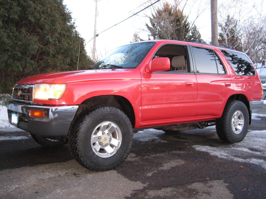

Here is my 97 with 15's and 31x10.5x15 BFGs and no lift
