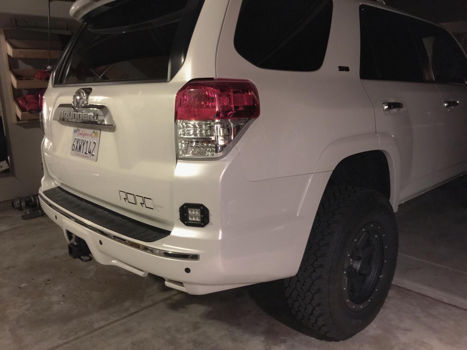

I did what wfo9 mentioned. I heated a box cutter knife and cut to fit these LEDs. It really does cut like butter.
